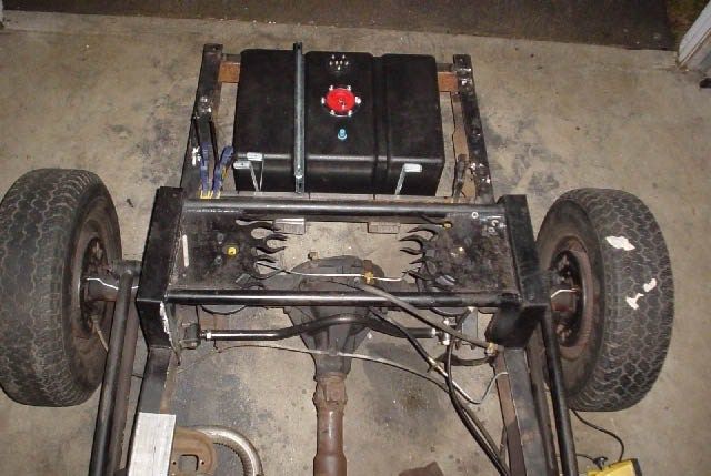

toreadorxlt
here is mine... super long and parallel to the axle at ride height. I dont really get much axle shift at all because it is so long.
