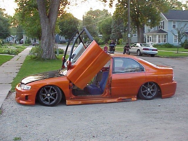

Originally posted by hybrid showoff
i'd scoop some up for my accord. just for the looks factor since it already sits on the ground (WITHOUT KIT)
am I missing something?
he siad he has taken the kit off and it lays flat but hasn't taken any pics.... not too sure about the truth in that; ALSO what are those 15's or 16's that is kind of cheating in a way
HS
hybrid showoff
YUP, lol those pictures are from last year.
HS
hybrid showoff
and those are 17's with 40 series tires....just so u know
