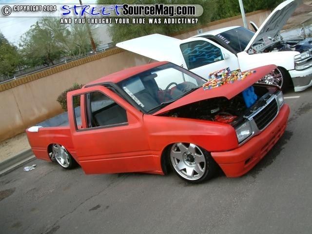

not that great of a picture, but on my old isuzu had a rodeo frontend. All you do is mock up the position of the grill and shit, i cant remember how many holes line up, just drill the new ones.
bobby7m
ok i have the rodeo front end on mine and all i did was line up everything, check that it lined up with the hood and corners and drilled some new holes. Granted, if you want everything to be prefect you should drill out the spot welds on the core support and weld a new rodeo one in but that's just a bit more work and not completely necessary. Just be sure your shit is centered and looking clean before you drill any holes. Make your marks, re-check, and drill. Not a huge deal. I also have plenty of spare parts if anyone needs them. I got some stock fenders with a shaved antenna hole and the inner lip trimmed away to fit the bigger wheels and turning while low. I also have a baddass stereo for a non-bodydropped pickup. It all fits completely snug with the bcak wall of the cab. Take a look at my profile for pics. Everything you see is included in the sale. Later
