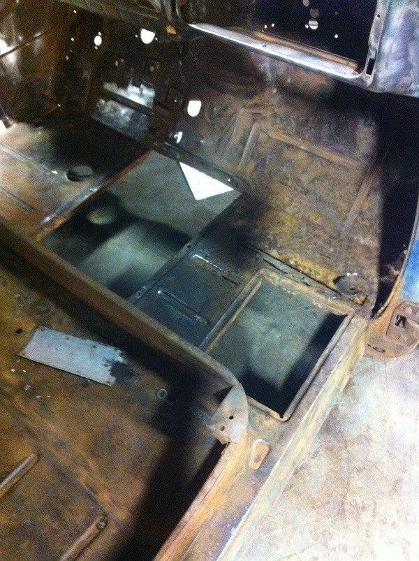

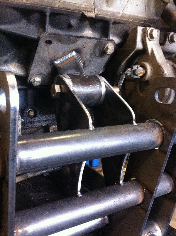

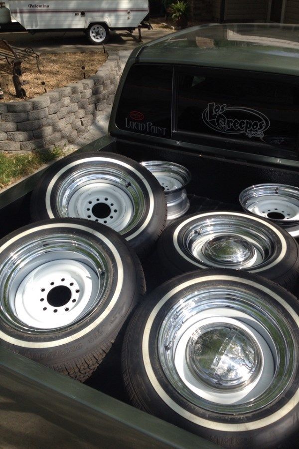

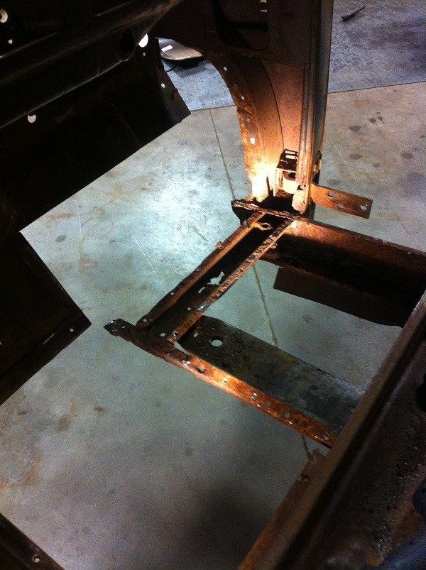

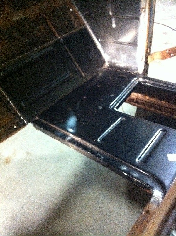

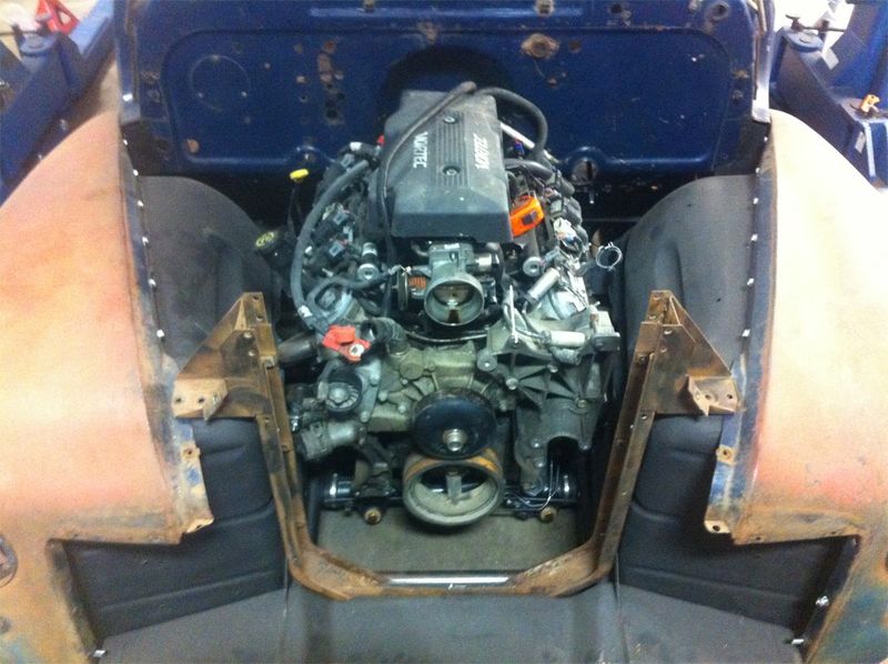

Got a few hours his week to work on it. We located the wheels and tires were gonna run. Most of the parts showed up late today so I couldn't do a lot. Got all the air management, balljoints, and rack & pinion. Then I fixed some rust while I waited on parts and got the motor mounted

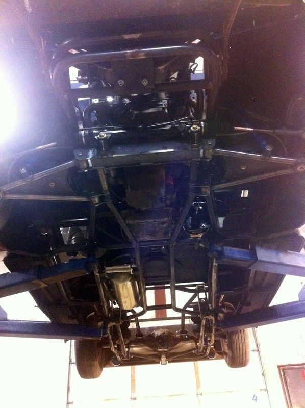

The track width on my frontend is 58'' WMS laid out, and 63'' at its widest with the arms parallel to the ground on a 29'' tall tire. If the track width needs changed I can do that in the cradle, but will affect the toe change throughout travel.

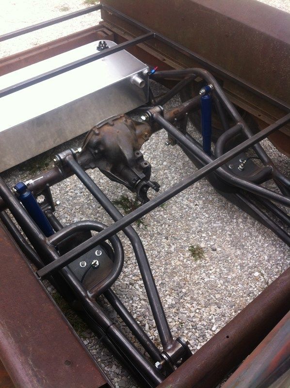

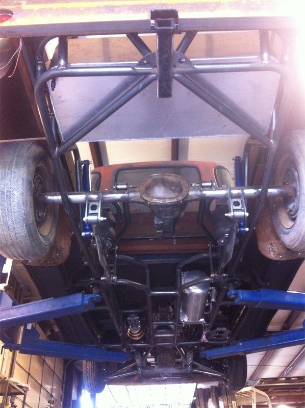

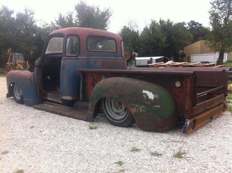

Havent worked much on it with having other jobs going through the shop, but the cab mounted and replaced the rear corners, maunted the frontend and running boards, built a 23gal aluminum fuel cell, and got the rear 4 link done along with TONS of welding. I got the wrong spindles shipped to me so that's holding us up on getting it to a roller but my guys taking care of it.

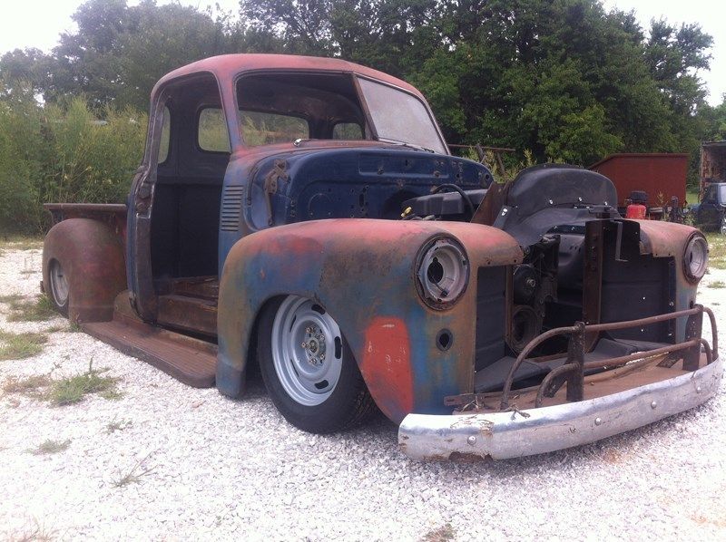

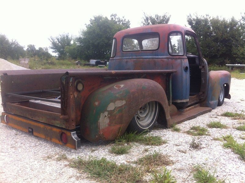

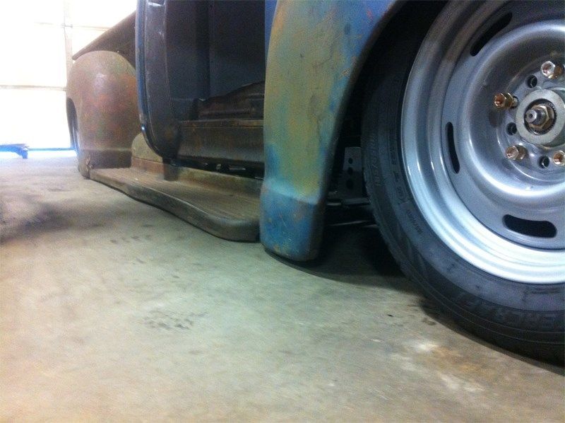

Long time coming but I finally got a few days here and there to finish it up. Its a full roller for now and the owner will bring it back periodically to button up the details. Full pics outside tomorrow.
guiltybydesign's avatar
guiltybydesign
more
jaredmxg's avatar
jaredmxg
nice work for sure. Its crazy how tall the frame is and how much that cab can hide. keep it up. Glad you are able to post pictures up while us others are slacking on our project.
