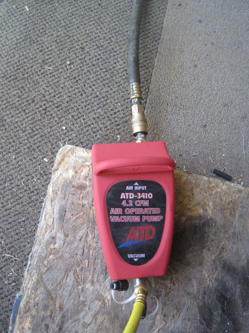

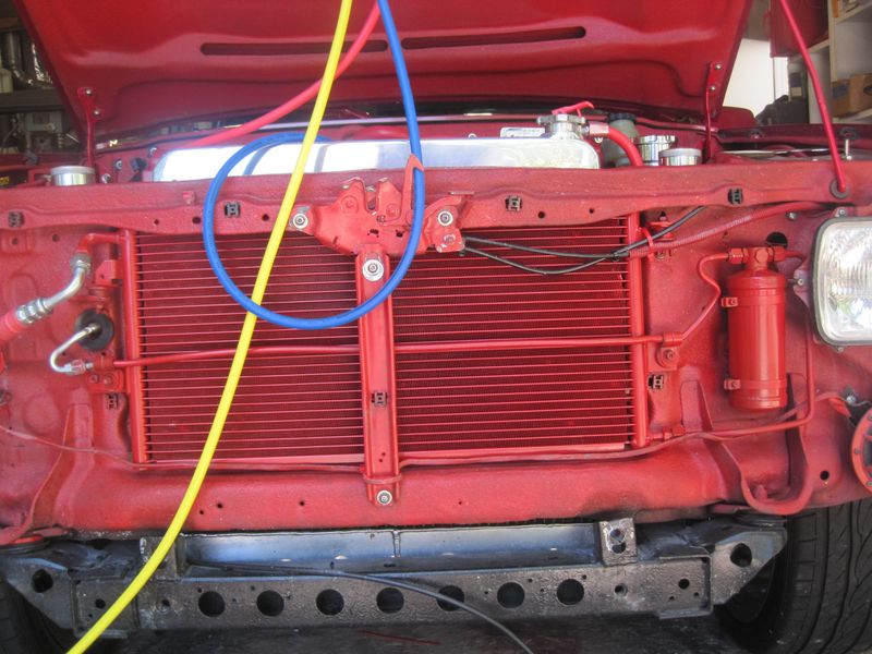

So I got the new condenser & drier in place( yes drier is sealed), & all the new hoses & fittings in place . They will come off once again to get crimped.Also ordered the vacuum pump & gauges to evac & charge my self ,as the shop can't do within my time frame!! Will add dye @ the charge cycle so if a leak can find it!

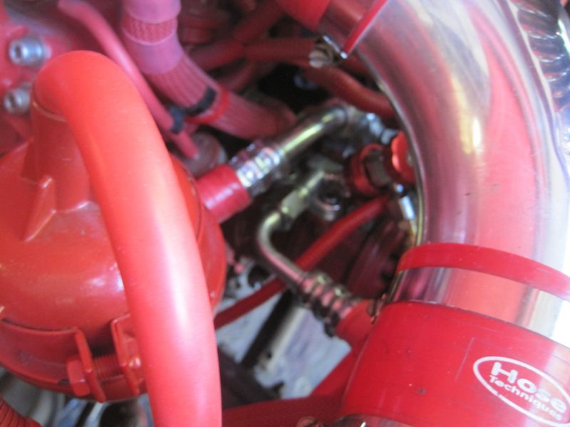

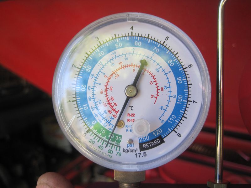

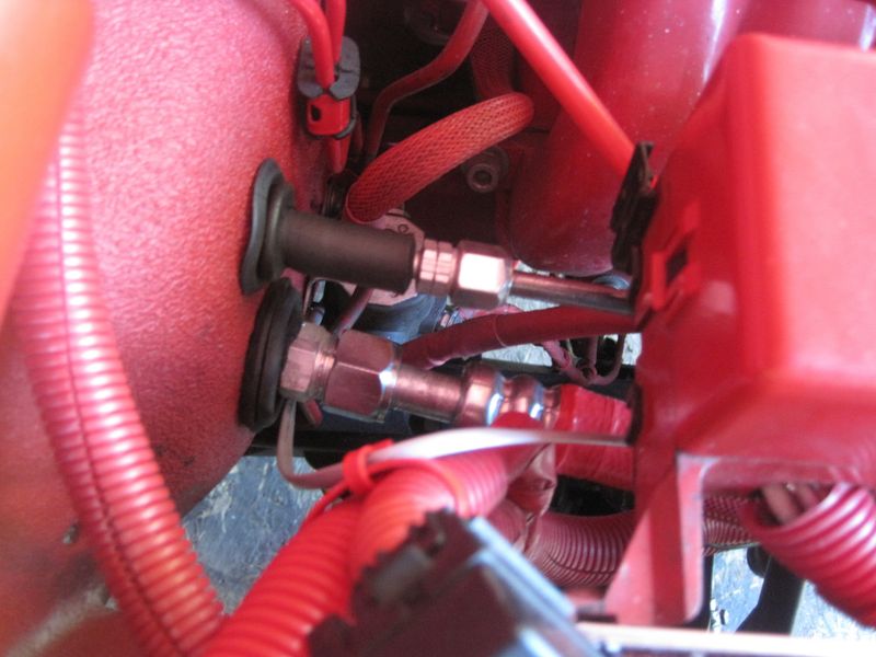

Finished this project up. Got the hoses crimped & covered with the sleeving, applied vacuum, added dye & charged the system up. Works fine!
