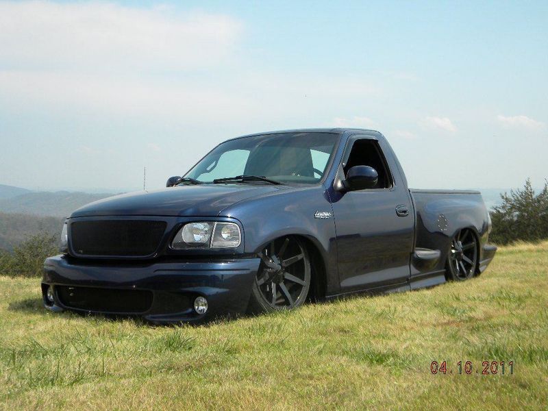

LType
Its not that i want the crazy camber. I mean I dont mind it as its only like that when completely dropped. It became obvious now with this setup that it was necessary (i think) with the wheel dimensions I have. It looks as if the Michigan Metal Works ones may be the way to go. My original plan was to use DJM control arms and spindles to correct camber as I had seen some do back then. Sonce the truck is for sale I would really just like to get some more DJM lowers and fix the rubbing issue, but as yall pointed out once again the MIchigan Metal Works seems like the best long term.
Here is the old setup
LType
