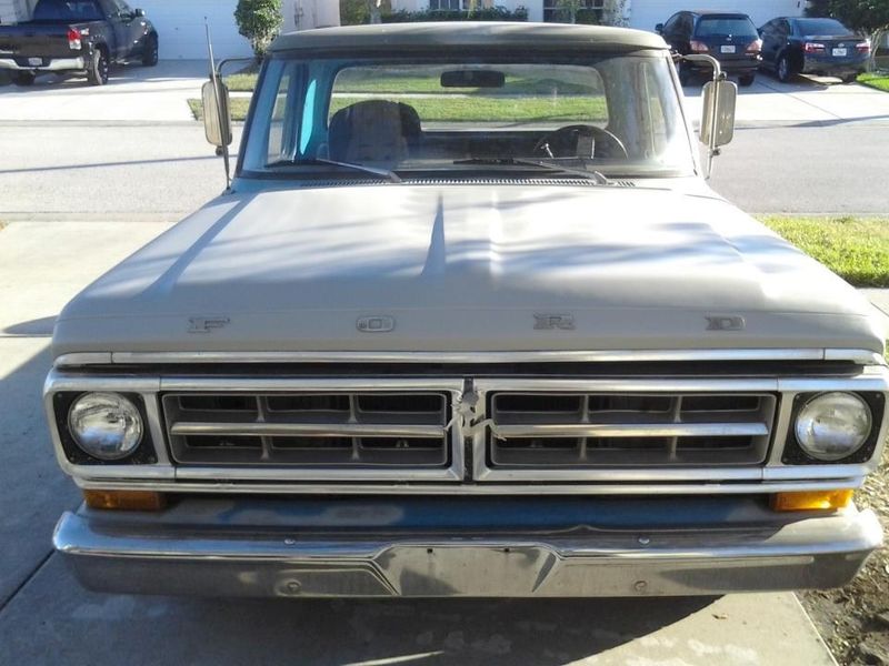

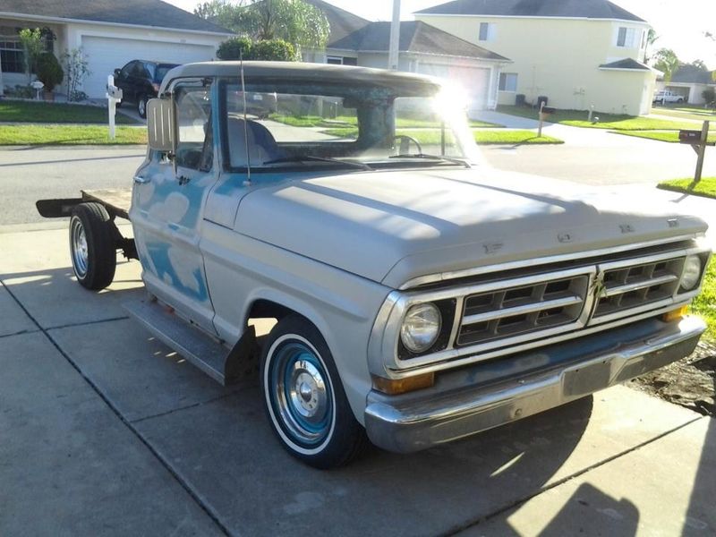

I want to body drop my 71 but it looks like the steering column is going to hit the power brake booster. Has anyone done one of these and can tell me what I need to do to drop her about 3 inches.

I'm going to get the I beams and bag it but I wanted to drop the body so I can lay rockers. Just not sure on what I need to know about droppin the body.

And what about body droppin it...what issues am I going to run in to? Or if I get the CV clip is it going to take care of the Steering column , brake booster issue?
MF
Master Fabber
Listen man just do a stock floor body drop and the column to brake booster dimension wont move. Tons of room under these cabs. You can do atleast a 4" tall frame rail under it. Tie that into the crown vic clip and do rear rails and your done. So dope and so clean.
