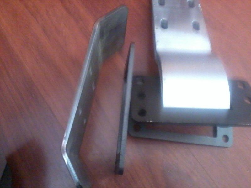

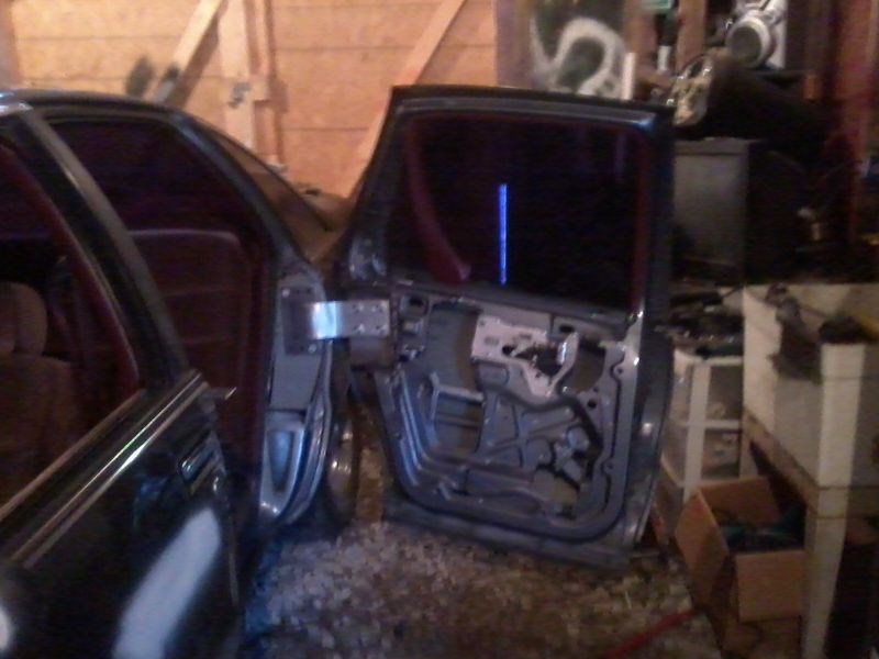

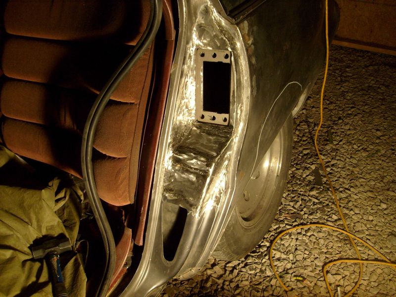

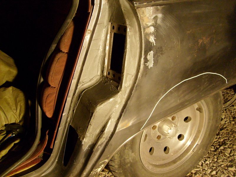

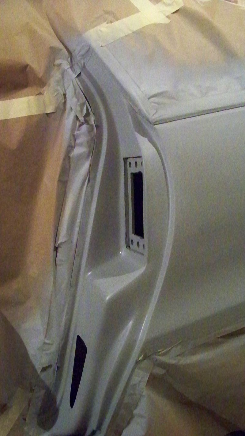

I have a 91 caprice classic 5.0 305 and i always wanted suicide doors on my caprice. I love doing all the work myself and all the pics of the work is what i have done myself. I got these huge single hinges from airbagit.com their $329 and they work great. I do have a video on youtube of the hinges on the door showing that their is little sag if any and how good they look. I hope you guys enjoy these pics their isnt many suicide back door caprice i only found 2 other thin mine and they didnt use single hinges.
