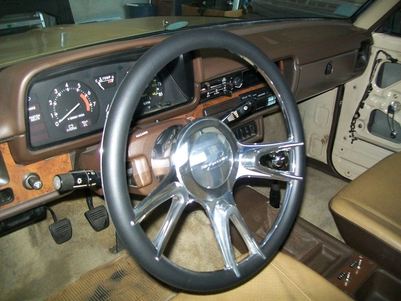

Hey guys,
Just wanted to let everyone know I just got done installing my new wheel/hub. The hub that I used and it worked is a Lecaara from a 89/93 pickup, same spline (Toyota of course) and the wheel is Billet Specialties called Fury, I'm really happy with it.
Now I've got a problem and I am sure other people who have done this conversion have ran into the same thing.
1. Installed adapter, as soon as it made contact with the shaft, the horn began to honk
2. Pulled it off and pulled the plug behind the grill
3. Installed hub (needed to switch the 8/32nd by 1/2 they sent me for 8/32 3/4 allens)
4. Put wheel on, hooked up red wire from hub to back of horn button, hooked up black wire from back of horn button to inside of hub (needed to drill and tap a 8/32 to give the wire/screw a home, hole was not there
5. buttoned it all up and NO horn, put in earplugs, pushed plug back into horn and solid honk
What do you guys think and or what did you do to fix the problem, I want a horn, I feel better when everything works right.
Thanks guys,
Pete
PS. I know I need to get it out of the garage and get some complete pics of the truck instead of just what I have done and stop bing lazy right.
tacomatoy2001's avatar
tacomatoy2001
Heres a pic:
MF
Master Fabber
I am pretty sure a horn works by grounding the circuit. Maybe the billet is making that ground now instead of something plastic? Just a thought.
