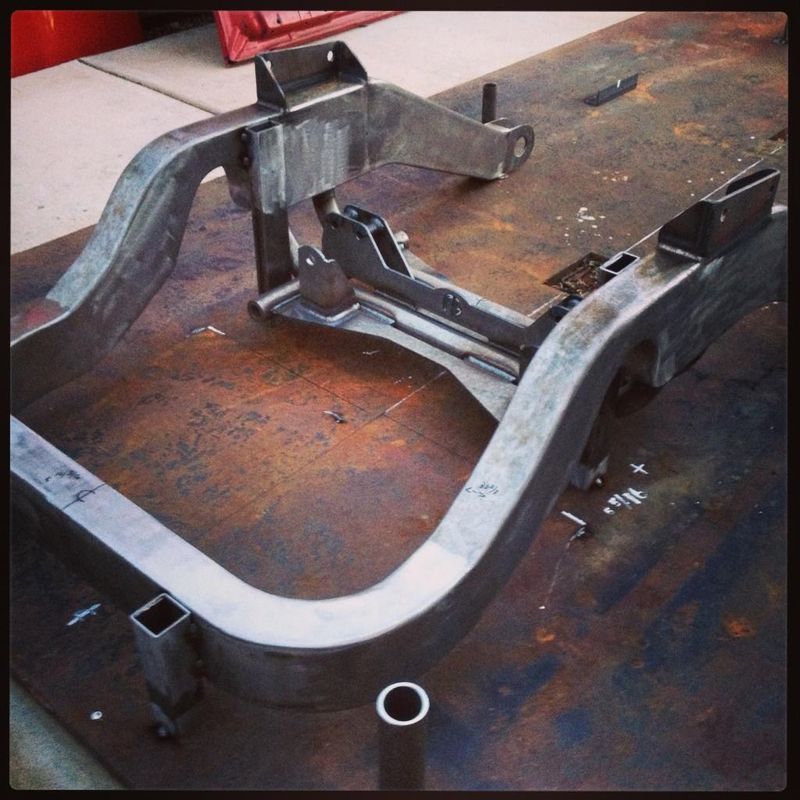

some more

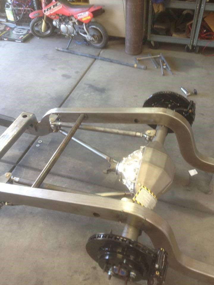

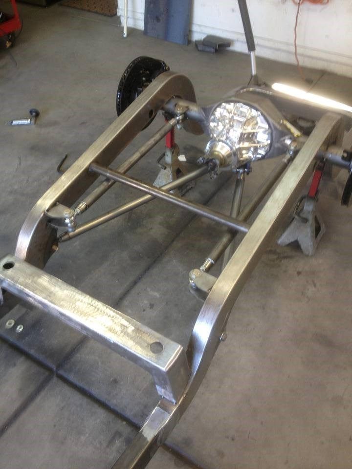

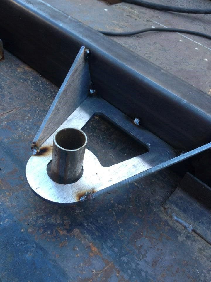

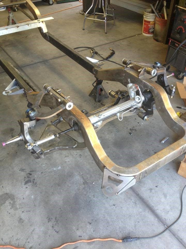

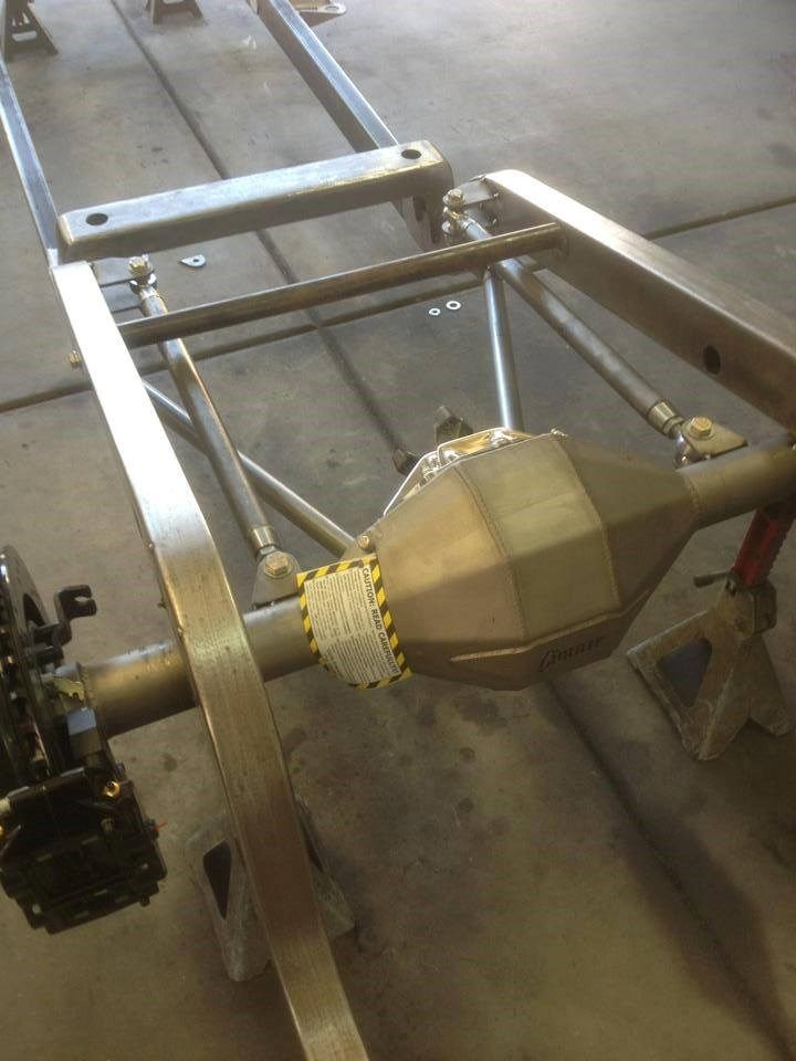

very sick dude loving the frame work an suspension. is it gonna be a cantilever juice setup in the rear?
tre5
No, it will be a torsion bar suspension with the hydraulic cylinder pushing on the torsion key to lift the suspension.
jeebus @ mmw
cant wait to see that!

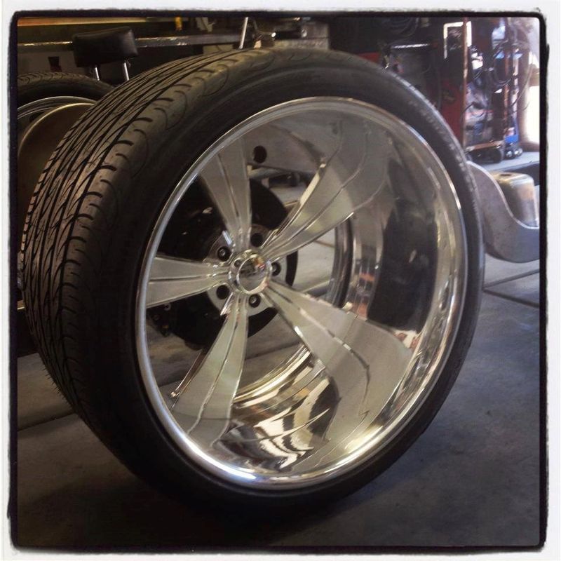

Got the front 14" Wilwood rotors on as well as mounted up the 24x15 Intros.
truck action
Sorry ,but wheels are just too big!
NtotheIZZATEDOG
Big badass wheels! Very nice!
flnole78
I think they will look right at home under those fenders!
i3owdown
Beast. this is going to look killer. keep up the great work and of definately keep posting.
