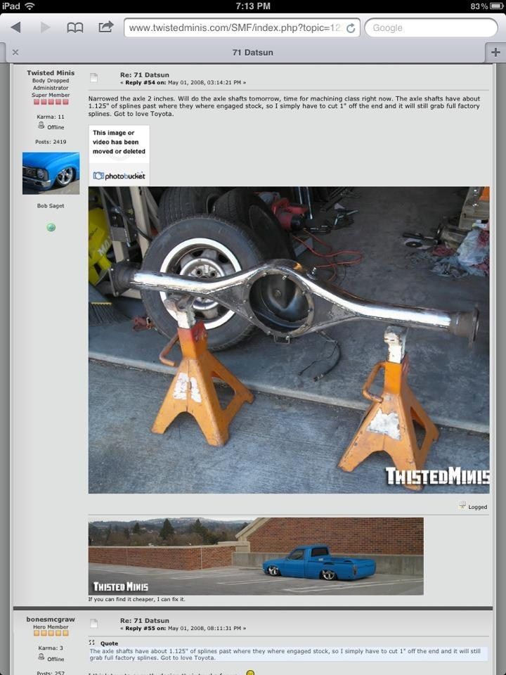

I'm not sure but I thought I read somewhere that you could narrow the pre tacoma axles just by cutting them down an inch and there was still enough spline left. I'll try to find it.
mx_wrench's avatar
mx_wrench
found it
mx_wrench's avatar
mx_wrench
burnzya's avatar
burnzya
the axle seth did was a super early hilux axle. 73 if i remember him telling me correctly. i asked him before i did mine and he said to only go 3/4" and not the full 1".
i don't think the newer axles have the extra spline. you could pull an axle and see where it's been riding on the splines. if there is extra it could be done.
or you could go with another older 84-88 axle and not narrow anything. each generation was more narrow then the next. my 73 axle was something like 53" and i took 1.5" out of it.
