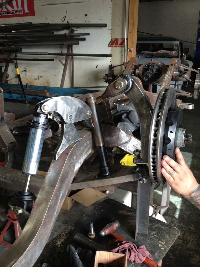

Is it ok to weld tabs directly to the stroke housing?

but ... it can be done, if done correctly, and carefully:
