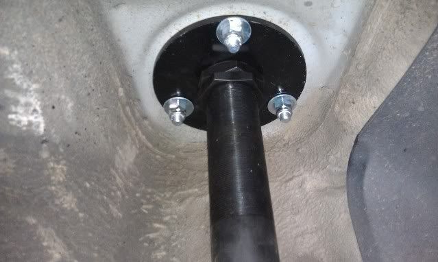

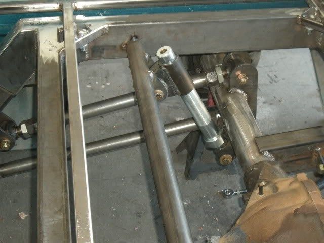

The upper mount needs to float, as you say. The only car I ever welded a doughnut to the threaded sleeve was on my mercedes and the doughnut was not bolted to the car. Normally I bolt in a doughnut to the factory strut tower and then the threaded collar (or jam nuts if they are my cylinders) just rest against the doughnut like this...In the hondas and other types of cars like a honda the cylinder needs to pivot at the top (and bottom) mount. If you were to weld it to the doughnut and bolt the doughnut in, it would try to bend the cylinder ram, and constantly be binding. I wish you would have gotten a hold of me sooner, we are coming out with a new type of cylinder that will work perfectly on custom types of installs and it sounds like it would have been perfect for your setup. But you can still get it done with the cylinders you have. If you're running a MII front suspension, the heim on the lower arm will be perfect. On the top you could do a bushing pivot like this (it shows the cylinder on an axle, but pay attention to the upper mount)...

So you say that on that 1st picture that kind of mount has some articulation? I would have thought that was solid.
Second pic is a very clever set up. VERY, but dont think that would work on the front. althou you got me thinking, in a good way, and if i finally decide to go coil less pivoting the ram on top would be a good idea, rather than have it free floatin through a hole on the perch.

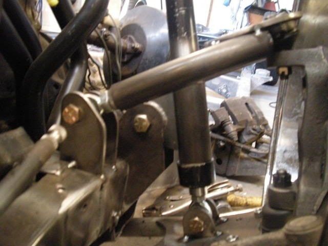

On the cars there is not a need for a lot of articulation, but yes that will allow the cylinder to pivot as much as is needed. I make the holes very tight (.010") to keep the noise to a minimum. I am currently working on a setup that will keep it totally quiet though. And working on a new cylinder as well. We have a lot of great ideas with Dice Suspension Components, it is just taking us some time to get it all going.This is how I did my Mazda a long time ago with cylinders that were not threaded...

I like how that Mazda front look, really, but doesnt it need at least so give to the sides?

On the mazda there is a tube welded to a sleeve that goes around the cylinder. The tube is holding a bushing and then the tabs off the frame hold the bushing to the frame.

I like the second picture that you posted Jeremy :o)
