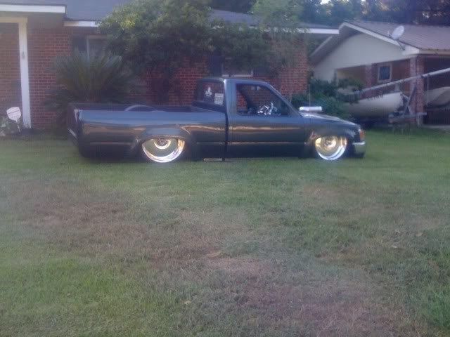

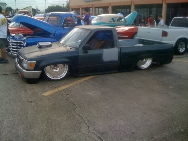

A guys truck from another forum I'm on.

Truck pictured above is laying pinch I believe on 22s I have seen it in person and know it still had room for a taller tire or laying rocker... I have mine set up to lay 22s also.. I have had a 235/30-22 tire under my bed with it off and laying the bed sides and it still fits.. My tubs are 1/8 below the top of the bed also. Main thing to worry about is backspacing or narrow rearend to bet the tire to miss the bed side.. I have an older 70s modle rear end under mine which is 2.5 narrower over all than the stock 89-95 rear end.. Any more questions man just text me at 618-694-2820.. Also I will be at showfest with my truck so hope to see you there!!!!
