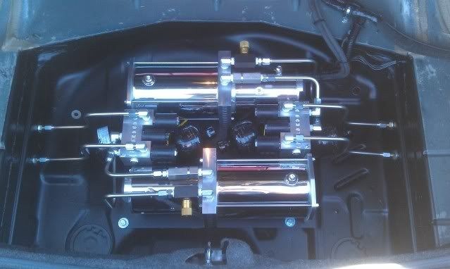

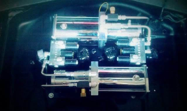

Started this one today...
mista337's avatar
mista337
I like the pump/dump/accumulator layout.
Can't quite make out the etching on the blocks & dump bodies. What brand components are those?
tre5's avatar
tre5
Edited: 3/19/2012 11:35:33 PM by tre5
Yeah, I made basically a false floor to mount everything to. Then I can do all my hardlining and mounting outside the vehicle then pick up the whole assembly and bolt the 4 bolts through the trunk floor. Plus these cars floors have a big angle on them, so this keeps everything more level at the same time.The equipment that was brought to me is hydroholics.

what size cylinders?
