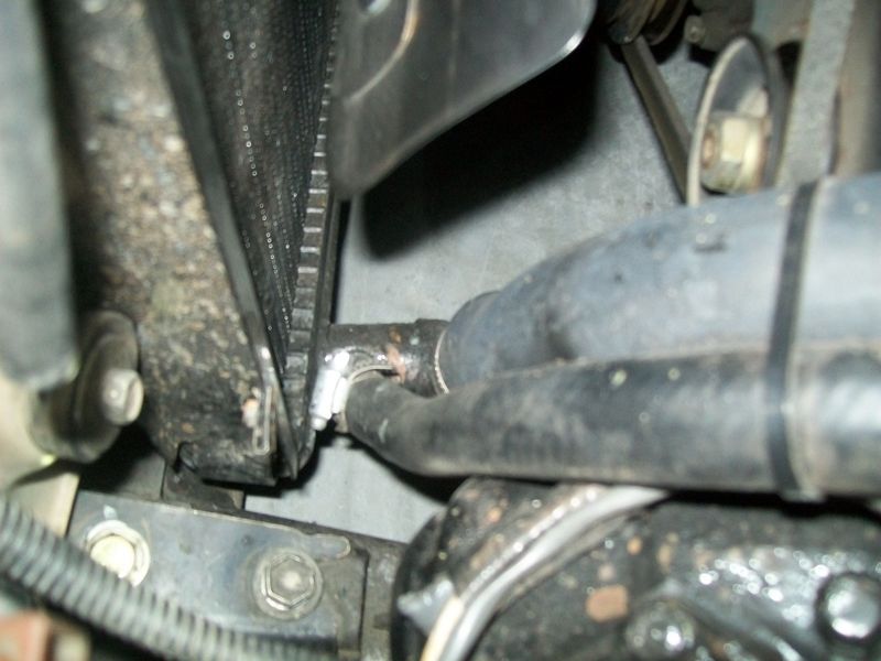

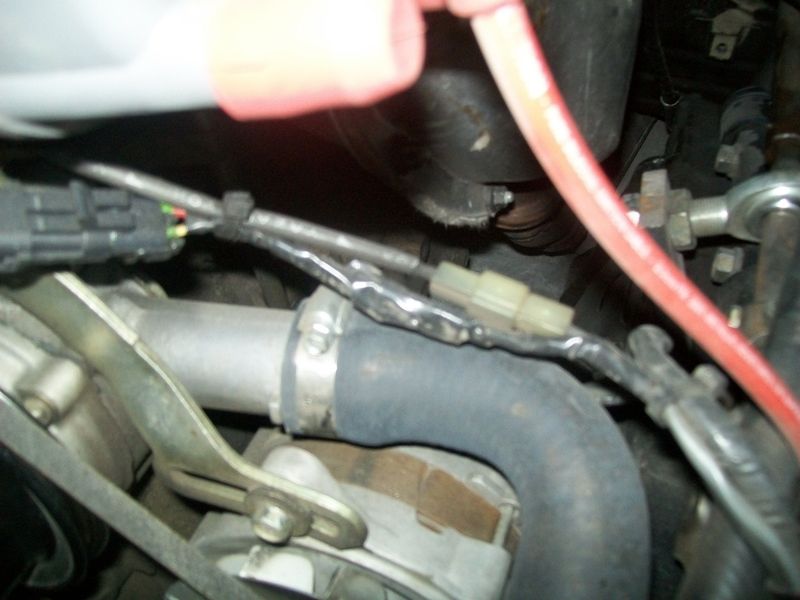

Ok man here you go. I just went and took these pics. My trucks an 82 Toyota bagged and stock floored and here is how my lower raditor is set up and I have had no problems with it. The bottem pipe coming out of the radiator has a elbow, an "L" welded on to it which looks to be approx 4". There then is the black rubber radiator hose coming off of that that loops up to the top.
After the body drop I got a whole new complete cooling system and this lower hose and clamps were included.
I hope this helps you out and you get your problem fixed.
Have a great night
Pete

sorry it not on the first message, I've got to practice posting here more, here you go.

I forgot, the length of the lower hose leading up to the top is approx 16".
