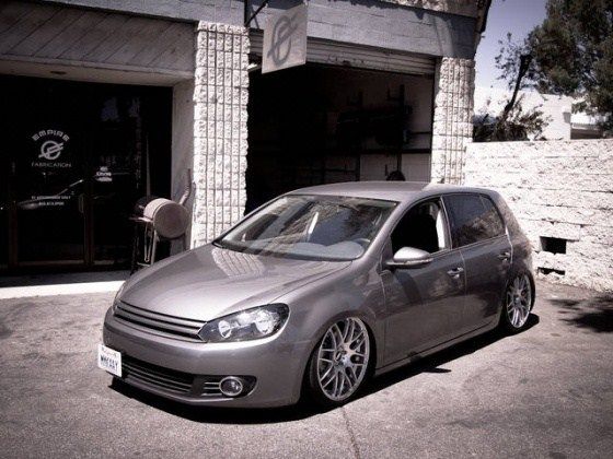

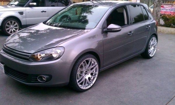

The tires are 225/40/18 but I have no idea on the rims 18x8 maybe with god knows what offset.
krz_hayn's avatar
krz_hayn
Tires aren't the problem. Unless he's going for the stretch/poke look? You can easily fit an 18x8 et35 up front with 225's and et30 rear. On the VW's the front sucks in a half inch when you lay it out.

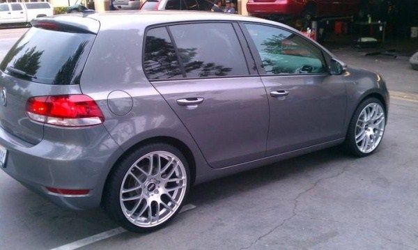

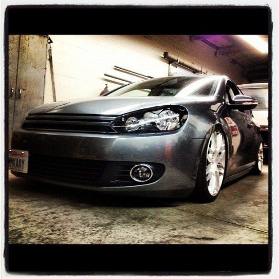

as promised here is a picture of the MK6 Jetta. The tires need to be stretched and it needs drop shocks or the bump stops removed in the rear, but the owner is happy so this is how it will stay for now.
krz_hayn's avatar
krz_hayn
Looking clean :TUP:

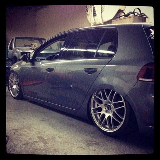

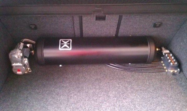

AccuAir E-Level ride height sensors and StopTech BBK finally installed

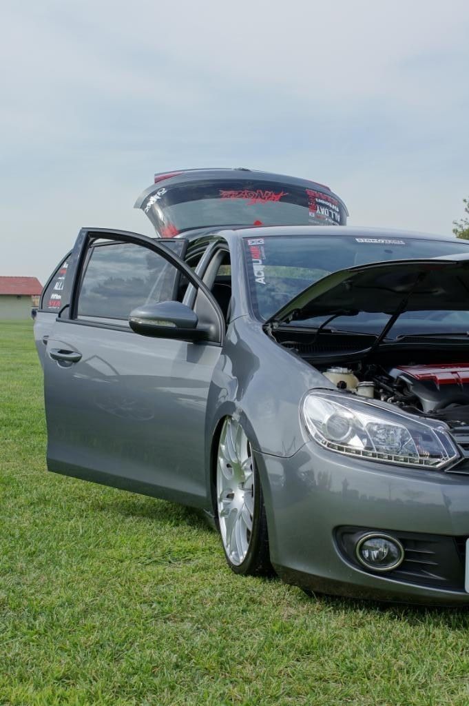

at Severed SoCal Show last Saturday
