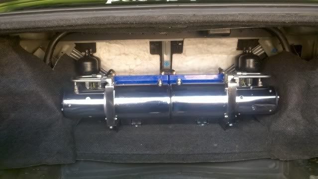

This car was purchased with the hydraulics already installed, but the new owner wanted to change it up. The previous setup didn't allow for any trunk space and wasn't the style that the new owner liked. I completely removed the old setup and I am still trying to clean up the battery acid and oil.The new setup will fit up on the shelf in the trunk area, leaving room for a full size spare tire and the stock trunk floor above it.Here is the new setup...I still need to mount the solenoids and then paint the rack, but it will eventually mount the entire setup. Doing it like this makes it easier for me because I can completely plumb and wire the setup while it's outside of the car.

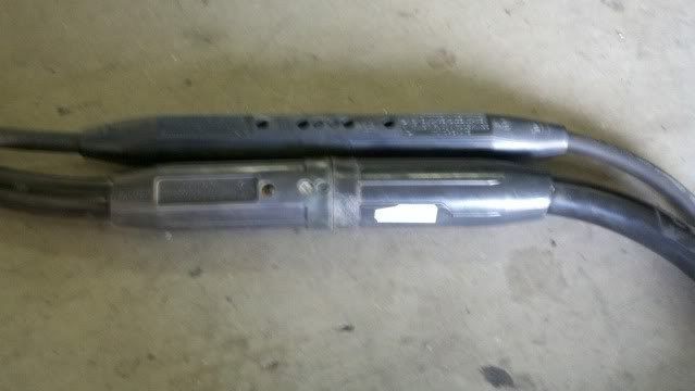

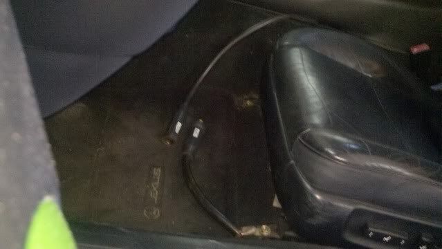

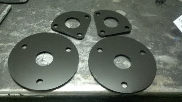

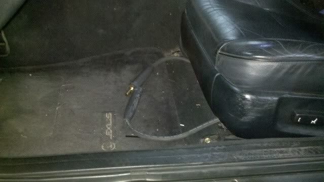

Removed the grossly over sized ground wire and ground clampInstalled a new more appropriately sized ground wire and clamp. Ran the wire under the carpet and grounded it out of site instead of to the front seat bolt closest to the door opening.Size differenceDrew up some new upper plates to get water jetted. Having the plates water jetted gets rid of most of the noise because of the preciseness of the cylinder hole.
