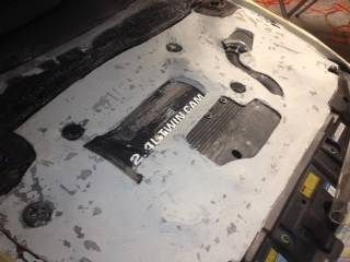

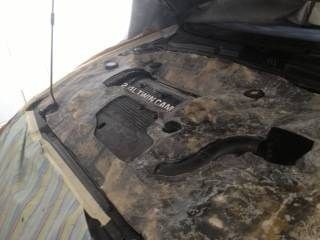

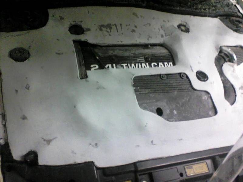

Well I wanted to work on my engine compartment this winter. I was inspired by some hot rods that have custom sheet metal engine covers. Unfortunately it was almost impossible to make mine symmetrical because of the lay out of the 2.4. I am not sure what colors I will be painting it, and not sure at this time if it will be for shows only. I have done research and it should be just fine leaving it in. This has been a lot of work! Holy hell. But I'm digging it, it deft. Goes with the shaved look of the car.
First thing I did was wrap the engine compartment with alluminum foil to work as a mold, then wrapped the whole engine bay with fleece very tightly
[IMG]http://i48.photobucket.com/albums/f205/broughtdown/a3da9d0c74339d98a77713f6ffbbb5d6_zps7aeabfb8.jpg[/IMG]
Next was to add about 5 coats of fiberglass with chop Matt and cut out the openings
[IMG]http://i48.photobucket.com/albums/f205/broughtdown/4aca6c0ee499c78021387ec299cceafa_zps452b0ec2.jpg[/IMG]
Next was grinding it all down smooth and coating it with milk shake (resin and filler mixed
[IMG]http://i48.photobucket.com/albums/f205/broughtdown/06c75b11836344afdc36e423720e4ba8_zpsca6b0249.jpg[/IMG]
And where I stand at the moment 2nd coat of filler
[IMG]http://i48.photobucket.com/albums/f205/broughtdown/c96f4f067dcc31cd5a43b66eb3e846dd_zpsfc7d965d.jpg[/IMG]
Also notice the wiper cowl has been made smooth, haven't had a chance to add filler. Enjoy!
