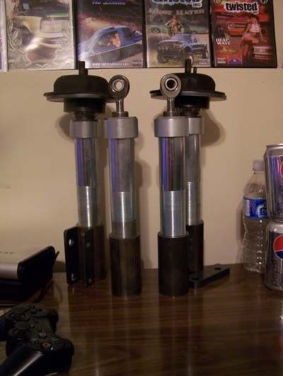

I have a mac strut in my Ion and what I did was get a plate made up that was the same bolt pattern as the strut tower and welded in a power ball and ran the strut up side down. You can kind of see what I mean in this pic. It was just a mock up of the parts before they were welded but it gives you an idea.
