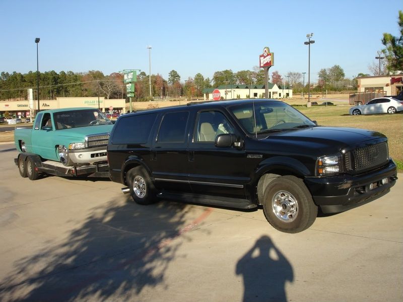

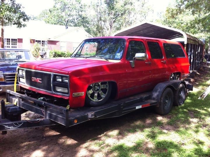

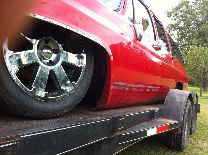

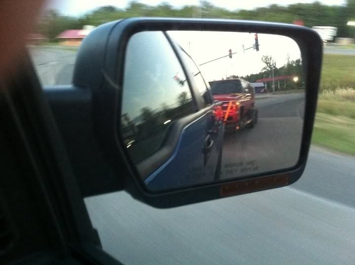

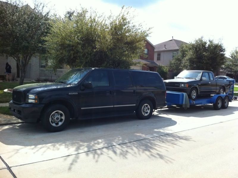

i noticed that the one time i trailered my s10 aired up, it tried to walk all over the place. That may have been because it was loaded on the trailer backwards (nose pointing toward the rear), but when we brought it back the same way (backwards) and laid it out, it was almost like the trailer was empty. Towing the burb i've always laid it on the deck, because the guy who pulled it for me said that it may slide around if it was on 2x4 or 4x4s, but i don't know from personal experience. I've always thought it would be better to lay it out, because when i pulled the stock donor from Tulsa, it bounced the trailer and truck around a LOT, and pulling the burb laid out was much smoother. Just my $.02 :D
and here is a pic for someone that asked.

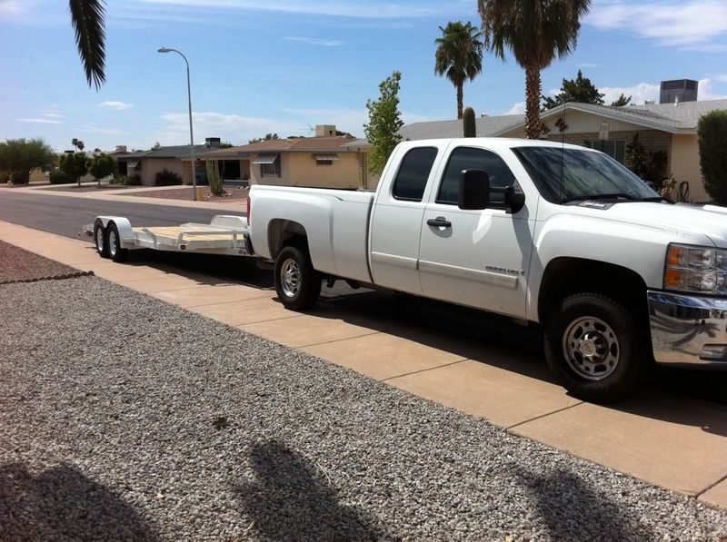

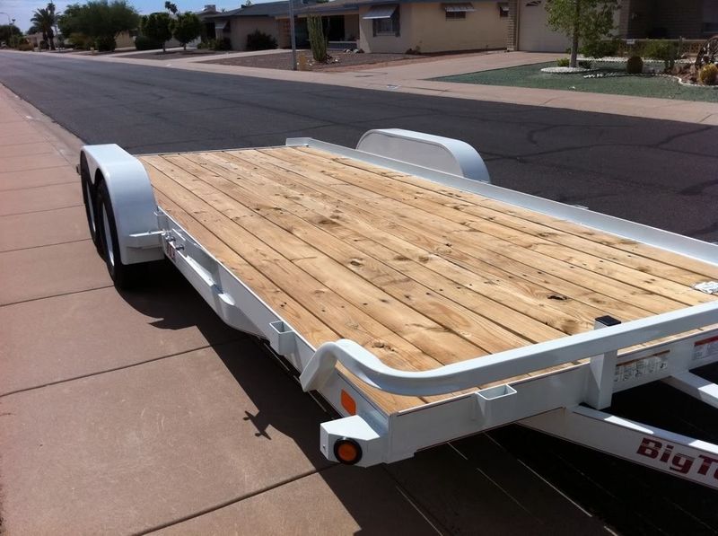

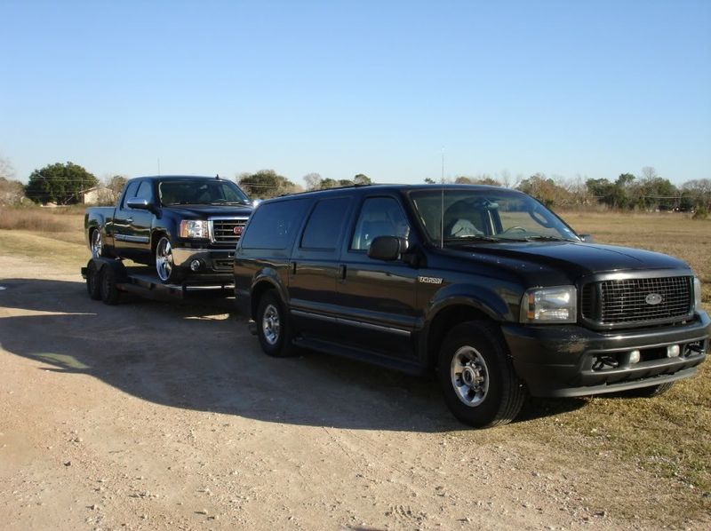

well the truck is a full size chevy i guess my only thing about towing it aired out would be breaking stuff like a couple of u have said may be possible when i towed it to sema it was aired up and it towed decent and the trip im making this weekend isn't real long but still id rather be safe then sorry im just scared if layed out i may break something on the truck or on my new trailer and i want neither of those to happen
this is the truck being pulled , the truck doing the pulling (moms truck ) and my new trailer
