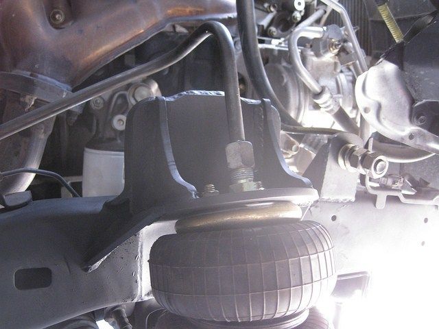

I know lots of people run cut spring towers and some get away with it, I for one dont like the risk involved though. There is still considerable force placed on the mounting point for the upper control arm and I have seen them rip and fail after time when left like this. That is why I came up with an easy and clean solution. Also helps to add some strength to the tombstone bag plate as well! Let me know what you guys think I am always open to feedback and trying to improve things.

I like that...simple and clean, yet so obvious...lol.

looks really good, great idea

I like that idea ...!!!

Here is a picture of this kit installed on a different taco
