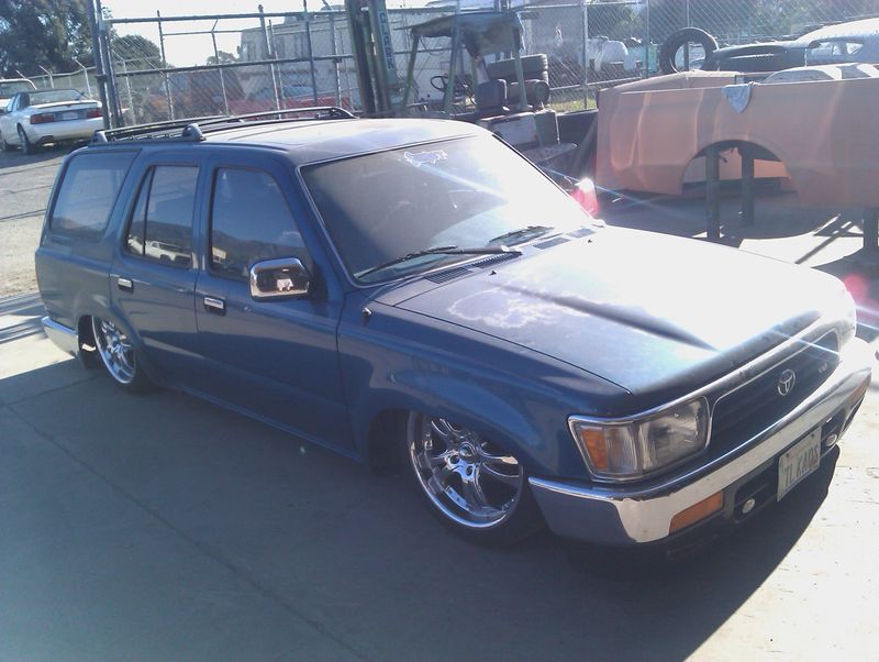

I don't have any pics of a 2 link but I do have a 93 4runner on a 90 yota fram with the back seat and I'm running a paralle 4-link w/panhand bar, bags over axle works great rides smooth.

bman619 (Bryan Dorn)
what size rims are u running? did u have to cut into the doors?
jeff hunter
bman619's avatar
bman619
running 18x8 40mm offset with 225/40/18 tires. for now at least, im not positive on how much was cut for the rear wheels as a fellow member of mine built the suspension and 4runner swap but from what i can see there was a cut into the stock wheel well but not the area where the door jam is.
thanks for the info.
i have a set of 19. think im go n with 17.
im go n for a old school look
