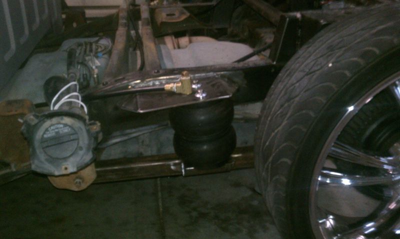

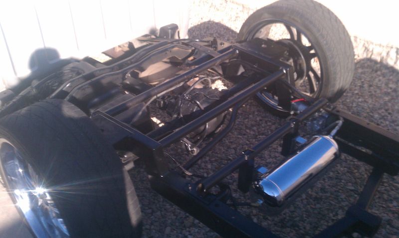

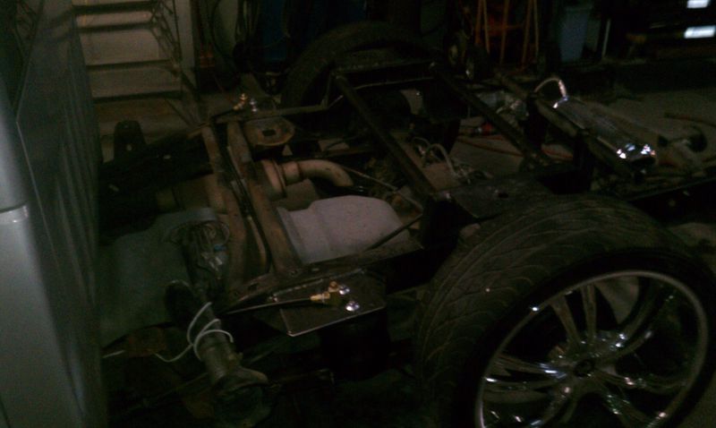

Here are some pics of when I built the first setup. The 2 link is getting scraped soon and im going with a 4 link with bag on bar. Just waiting for my fuel cell to be made.

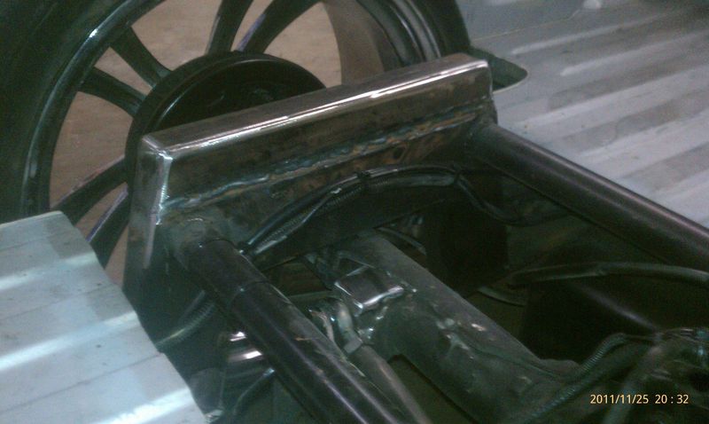

The first one is of a piece I scabbed on to the top of the notch to make it bigger. Once the fuel cell is in, ill cut the bottom out and box it in so I can go lower. Also, I was planning on putting bondo in the center weld so it disappears.

Since those last couple of pics where taken, I added to the notch (like first pic shows), flipped the pan hard bar around so I could install my shocks, added a viair 380 compressor (now 2), and shaved my bed post holes. Once I get the fuel cell and 4 link going, Ill post more pics.
