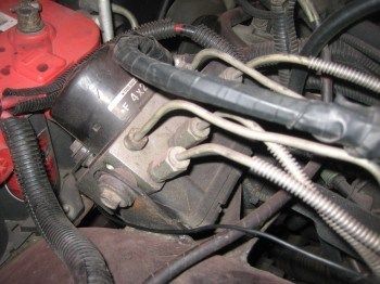

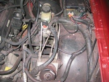

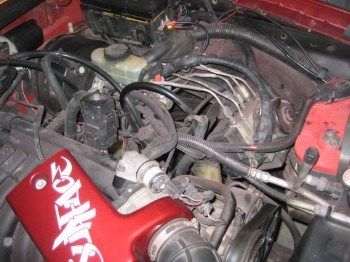

I dont remember, are you dody droppin it or just layin g the frame? well anyways, heres a couple pics of my 02 ranger...'Yoda just moved the ABS block forward and at a tilt, which turned the ABS light on, but they still work, i have felt the ABS motor kick in when it was supposed too.... but yeah, here ya go... let me know.. Dave
tmiit71's avatar
tmiit71
Edited: 9/6/2011 11:41:01 AM by tmiit
I dont remember, are you body droppin it or just laying the frame? well anyways, heres a couple pics of my 02 ranger...'Yoda just moved the ABS block forward, extended the wires and tilted a bit, which turned the ABS light on, but they still work, i have felt the ABS motor kick in when it was supposed too.... but yeah, here ya go... let me know.. Dave
