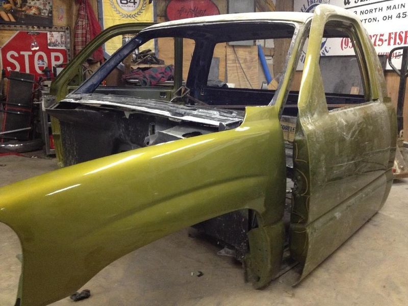

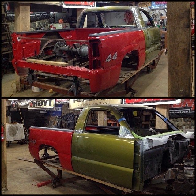

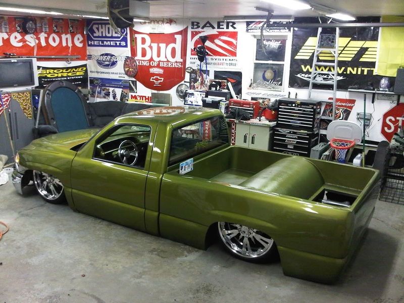

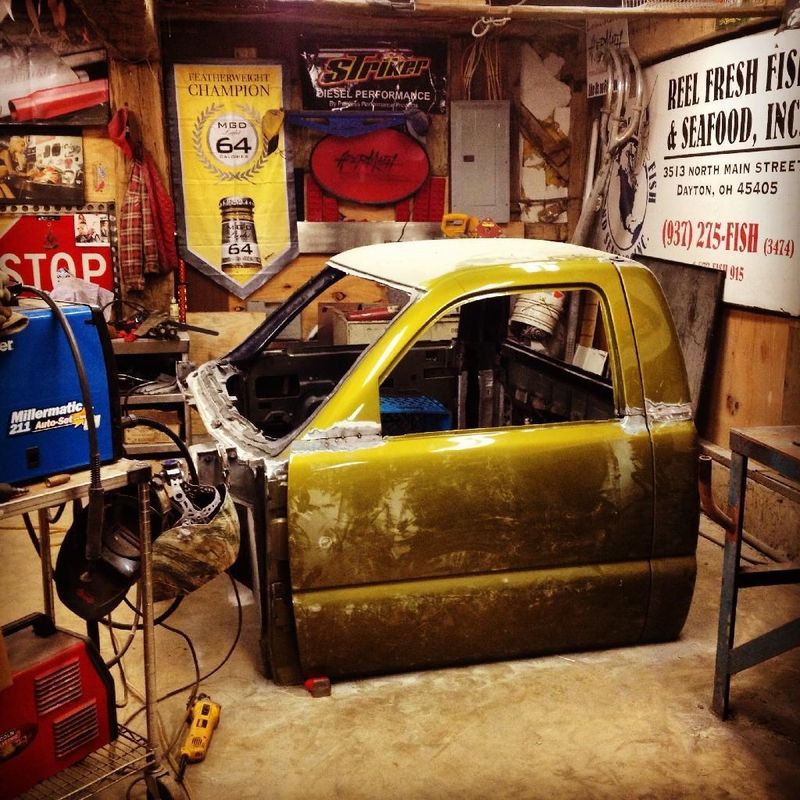

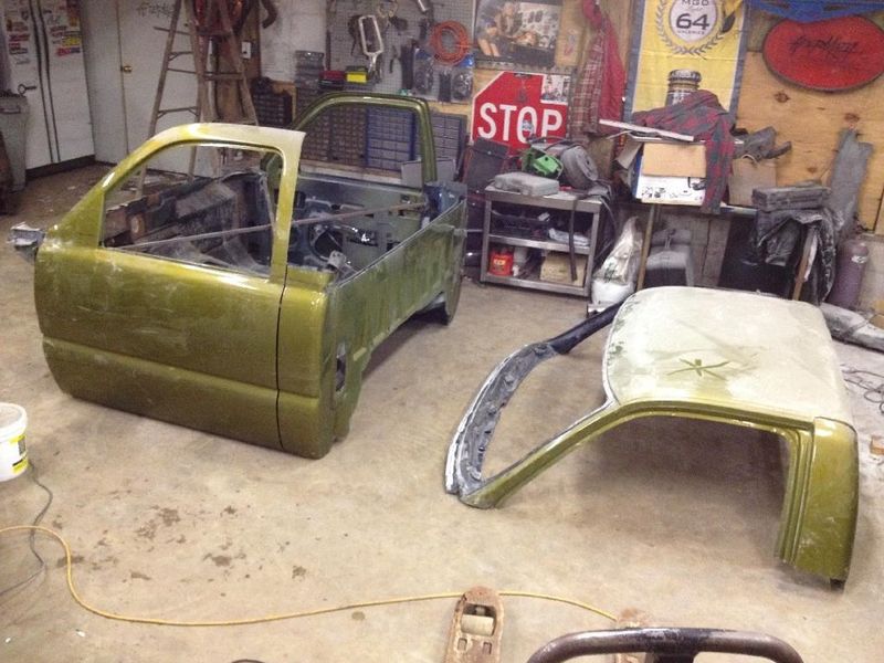

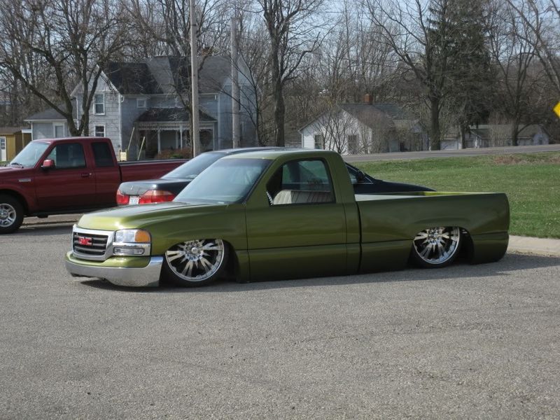

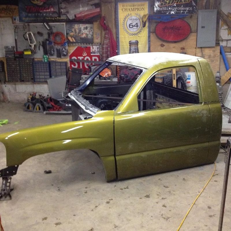

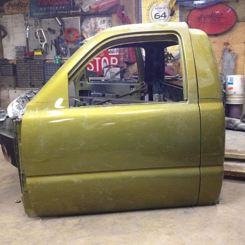

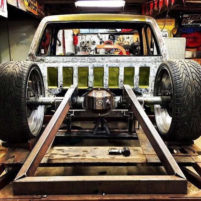

I agree. It's almost scary how well its going so far. Its like it was made to be chopped 2". I cant wait to see it with the 5.75' crew cab bed on it. My old 6.5' standard short bed always looked too long with the big body drop on this truck. When they are laying rocker the 6.5' bed looks fine though. I'm only 5'9 and I swear there was a good 8-10" between my head and the headliner haha. The cab is 51" to the top outside of the roof and 53" at the center highest point.

Man, I thought I liked this truck before! That chopped top makes me like it even more! Good work on taking the truck to the next level, keep us posted on the progress

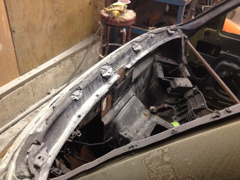

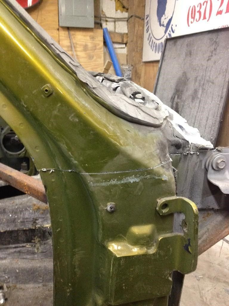

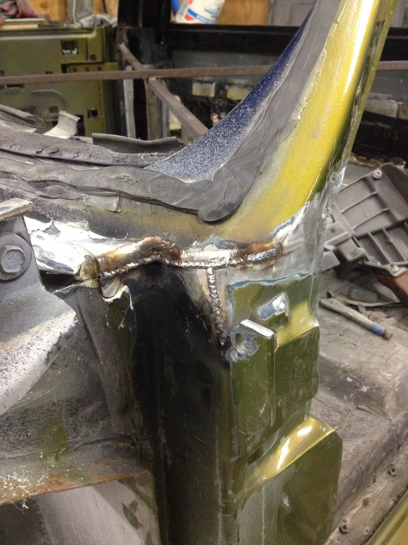

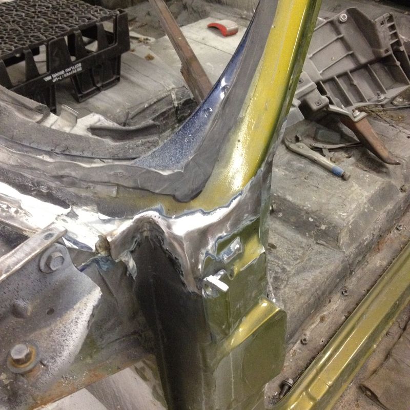

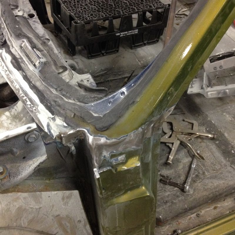

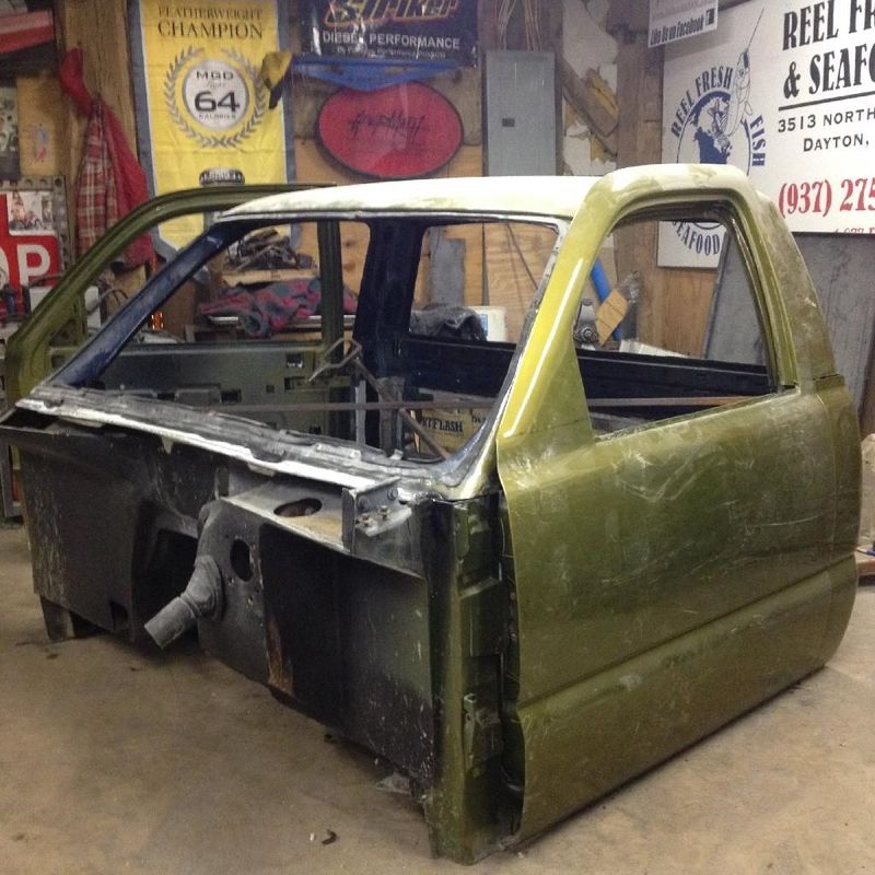

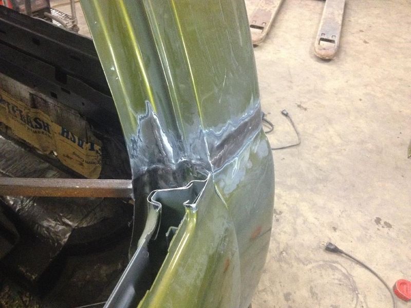

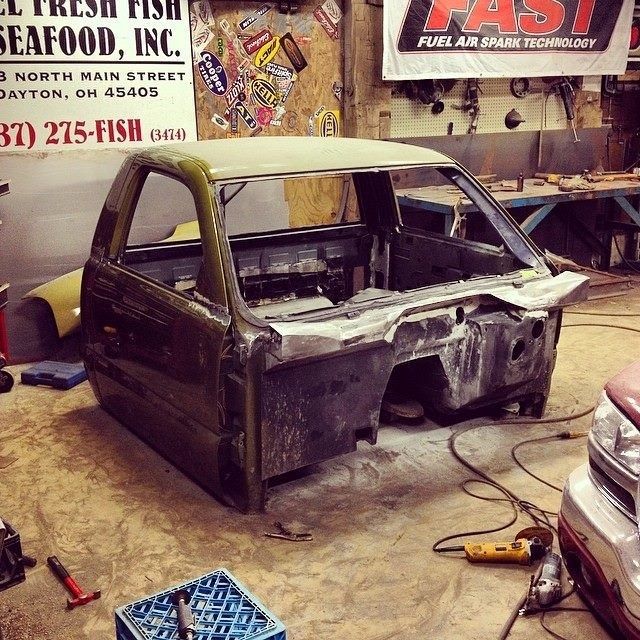

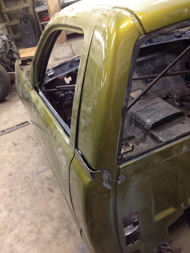

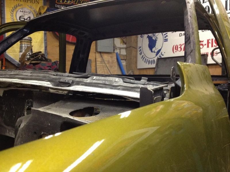

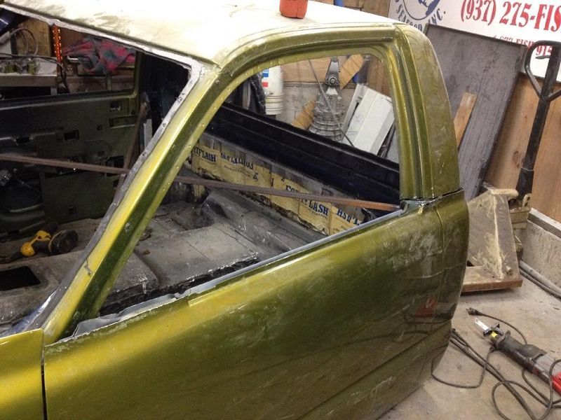

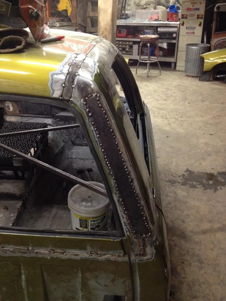

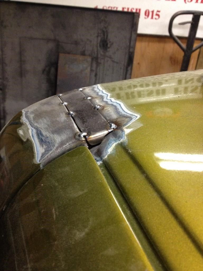

The passenger side didnt turn out as good as the driver side so I cut it out and put some more metal in. I think it would have been fine with some body work but I'd rather spend the time to make it right now rather than later on down the road when it's painted. Started to shave the top of the cab too. Another one of those things on the list that was supposed to get done before it was painted but got passed over to finish it. Trying to do everything now, and not cut corners. The problem is I dont know the most efficient ways to do alot of things yet...

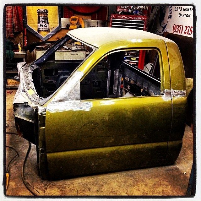

since you shaved the cab seams are you gonna radius the door corners?
Jcfreeman0's avatar
Jcfreeman0
I'm not sure on the doors. Homewrecker did look pretty badass like that.

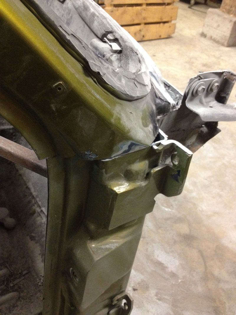

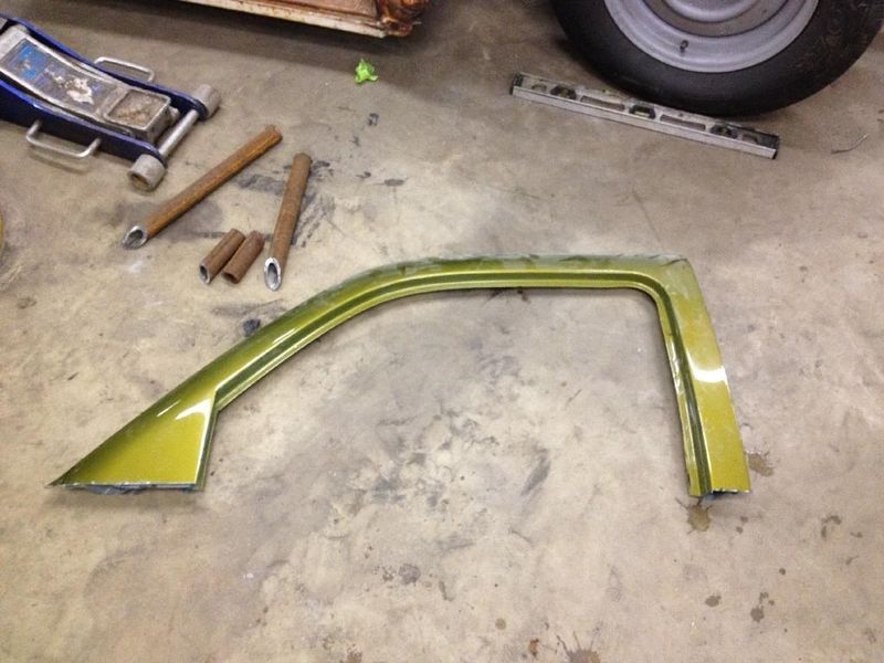

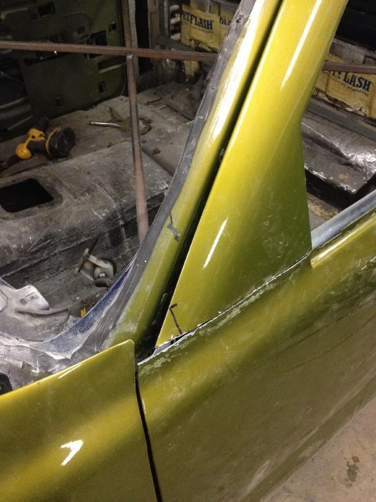

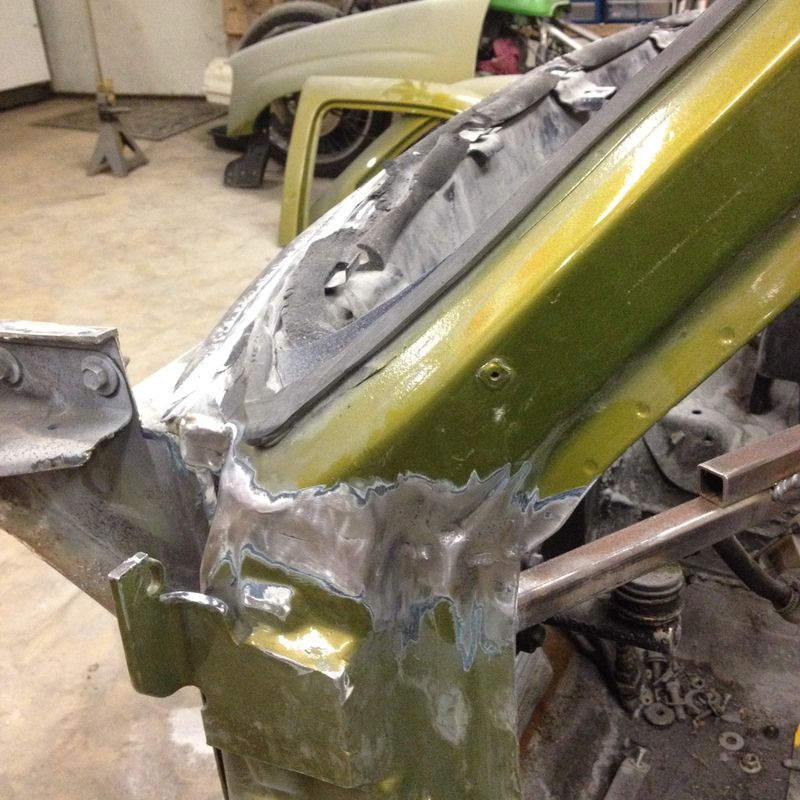

Rear pillars are now one. Got the 2nd gutter channel piece made. Almost time to work on the front side.
