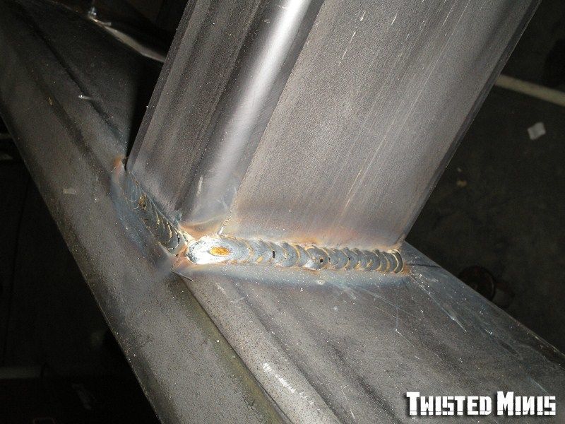

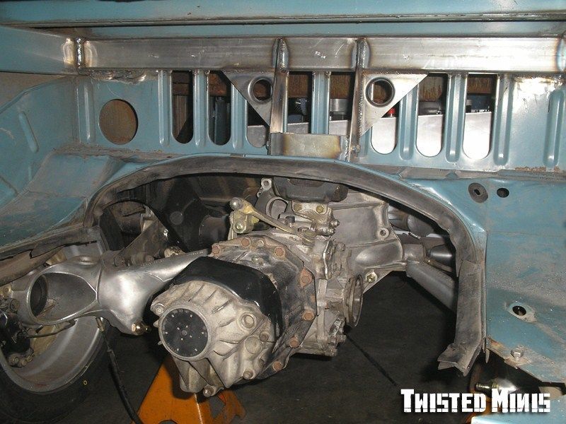

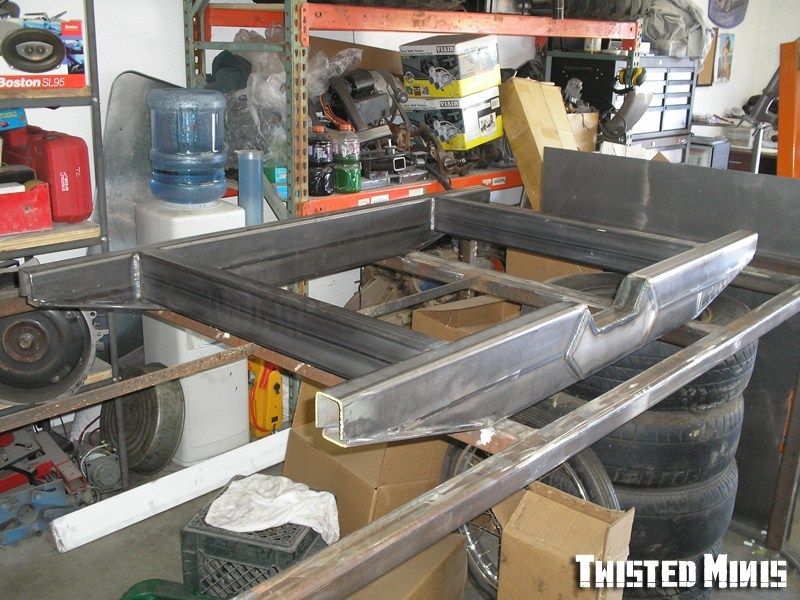

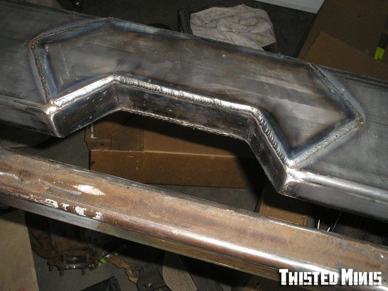

what size tubing is under the cab of the mighty max?
TwistedMinis's avatar
TwistedMinis
2x3 .120 wall.

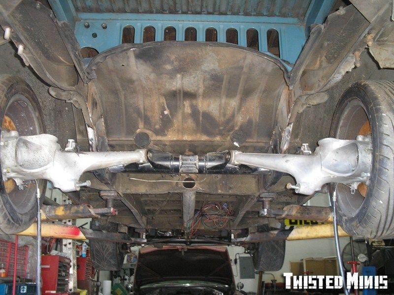

Some exhaust on the VW.
One side almost done, other side is a little more intricate.
A little more tweaking and I can weld the mid pipe to the muffler and cat, and then start on a crossover, or H-pipe.
bdydrppup's avatar
bdydrppup
ok cool. for some reason in the pic it looked smaller. thanks

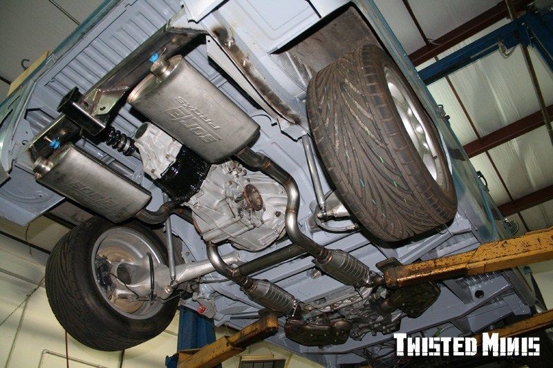

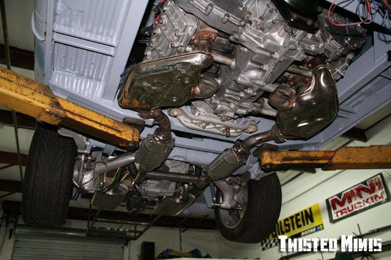

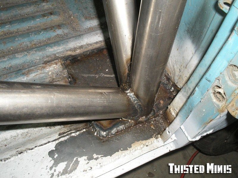

Here are the latest shots. I am basically done with the exhaust now aside from the H-pipe. I needed to finish each side before I can tie them together with the H-pipe. I am pleased with the way it came out.
It might look small because the back half is 2x4.

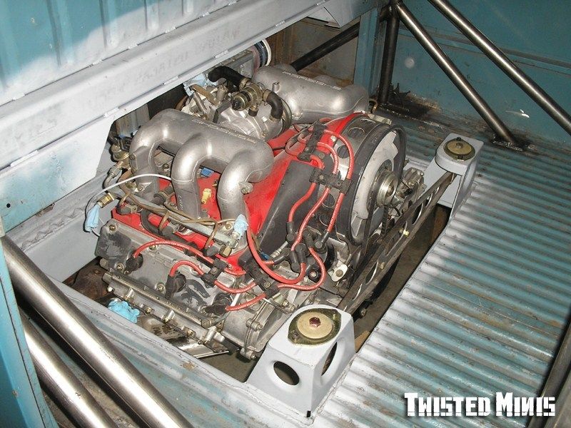

TwistedMinis

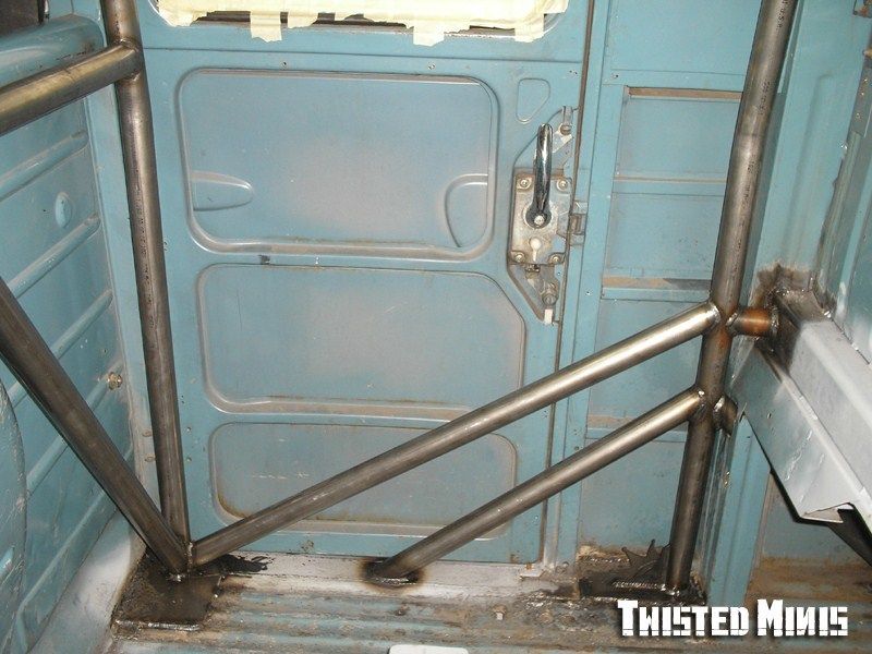

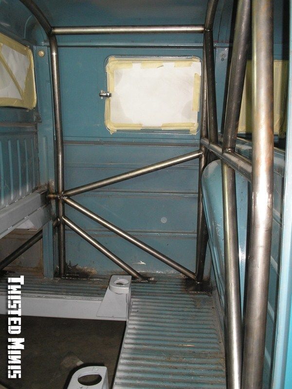

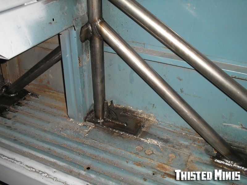

Here are some better pictures.

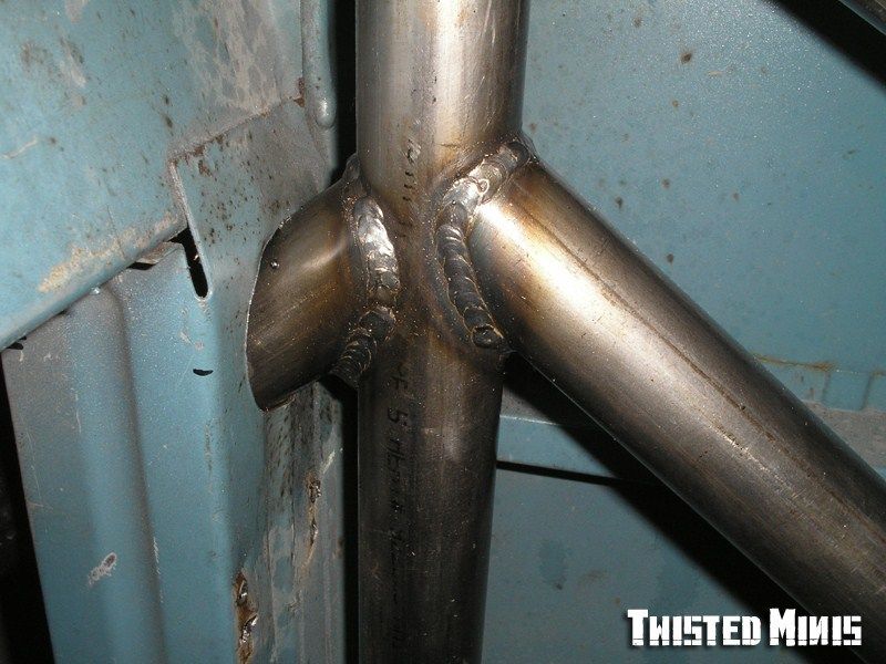

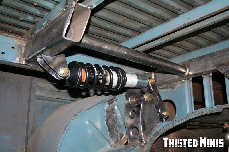

TwistedMinis

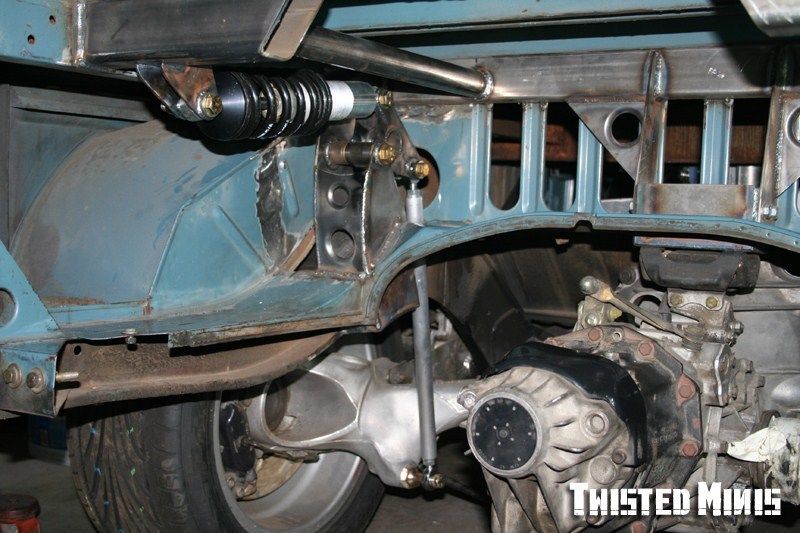

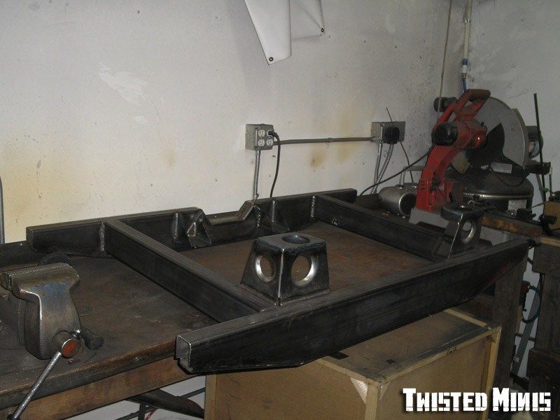

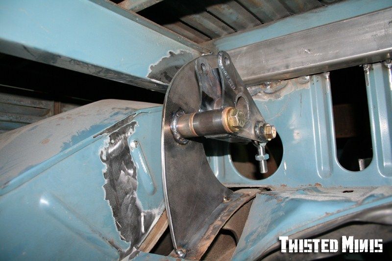

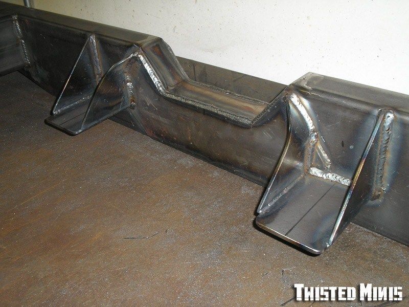

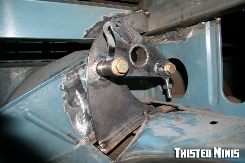

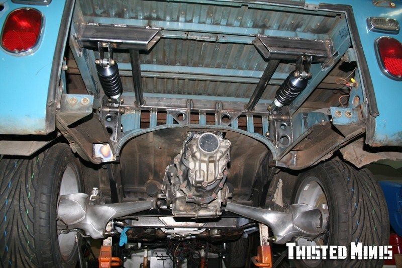

Here are the diagonal braces for the shock mounts and hitch.
