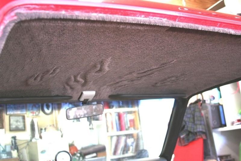

So I've been wanting to do this for some time .So this is the time!

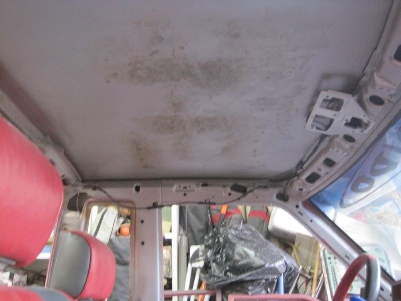

Got the old removed & the area cleaned

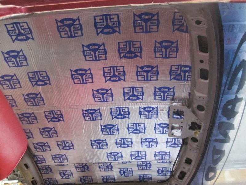

Sound deaden-er in place

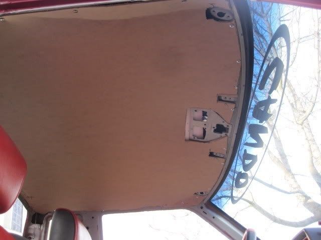

Today got patterned,cut & in place

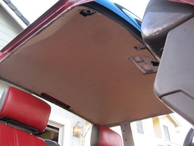

All is going great,next test fit the glass gaskets & all that goes back. Won't upholster until back in paint as the fabric as to wrap the cab lips.:BEERCHUG:

The hard material is wall panel,about 3/16'' to 1/8''.It is in place,using wide head #8/3/4'' & 1'' screws, starting @ the front ,then center rear,& moving to the sides. I trimmed as I went with a air grinder fitted with a zip cutter.You have to get it pushed tight,a slight curve @ the sides. I have a piece of hard form 1/2'' thick down the center,about 2' wide.The shell ( I call it),will be covered with a high density 1/4 form,contact cemented to it. Then I'll spray both the form & fabric with the same, using a cheap Harbor Freight small gun. The fabric won' go on until the painting is done,as have to wrap the fabric around the cab lips.This will much better than the stock bow type! I hated that ! :BEERCHUG:
