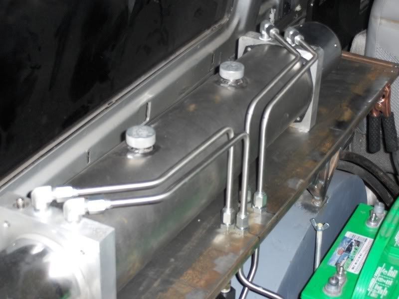

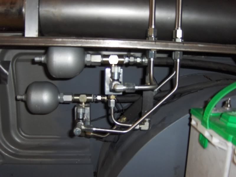

Are yall using stainless lines with regular steel fittings? What size and thickness of line are you using?
Just trying to figure this out. I already got a 37* flaring tool and a bender.
CUZIKEN's avatar
CUZIKEN
I used regular fittings on my install, i think there maybe zinc coated or have some kind of corrosion protection on them
