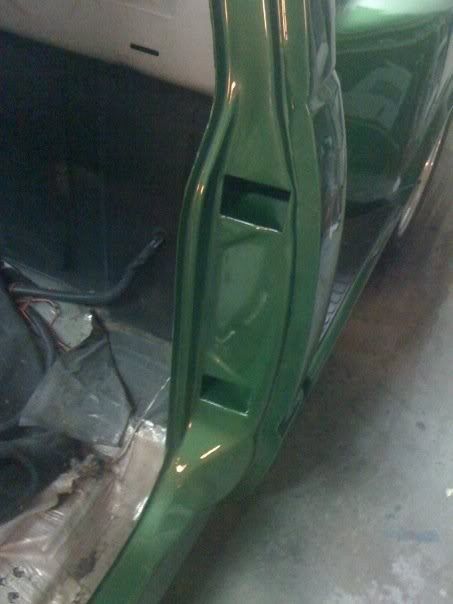

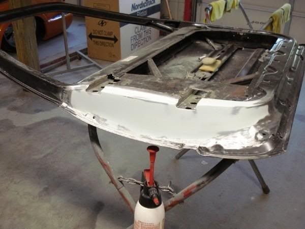

Here is my pocket placement.. you need to move them further to the outside than where mine were because the door scrubbed the body slightly when opening. I also, shaved all where the stock latch was.. I dont remember if this was necessary or not. you can see the plate inside my door... thats 1/8".. Also, tie the hinges into the cab.
thats all i got.
