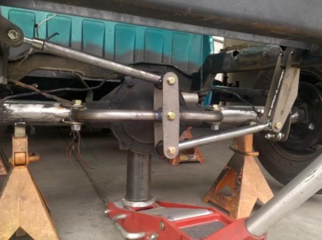

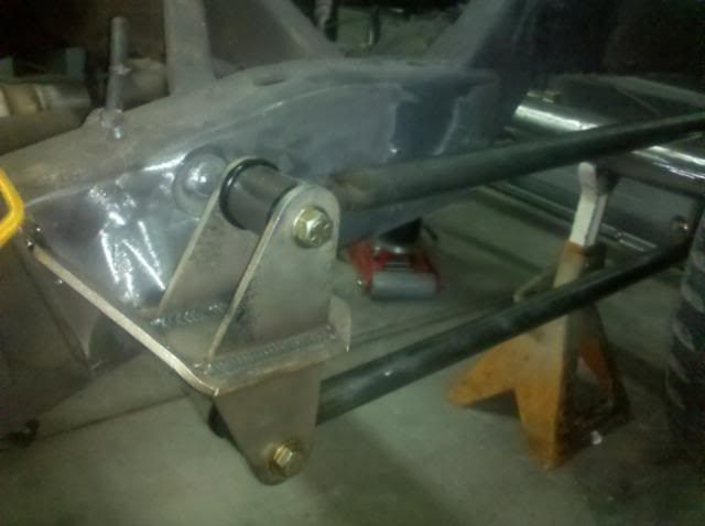

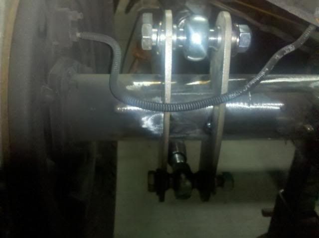

I sell a universal 4 link tab setup. I sell the tabs only for $110.I also sell a universal watts link tab kit for $100
Let me know if you have any questions. I sell all the bushings and heim joints as well.
