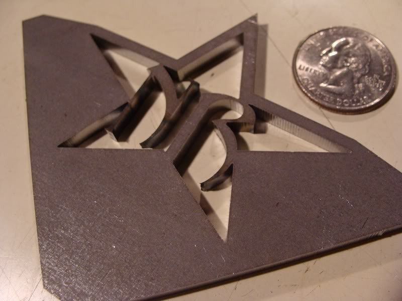

Heres a piece i cut 2 days ago.
If that aint precise i dont know what is.
