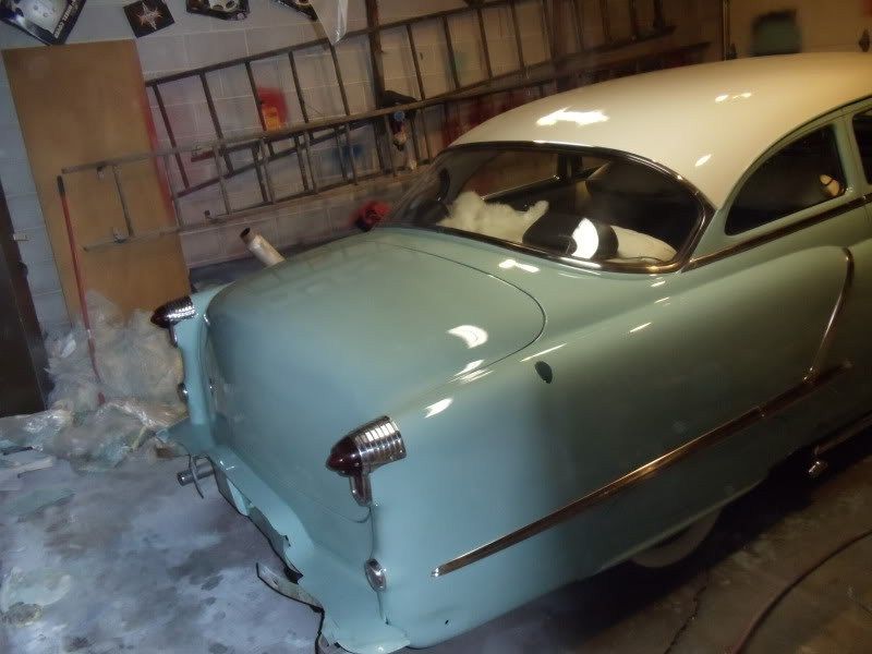

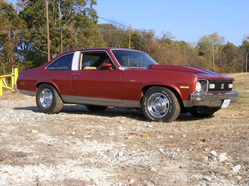

i say try it out, i did a few paint jobs in my garage and they came out pretty nice, i started doing hot rod flatz and for single stage, they came out awesome... just do the prep right and have a clean area, hell, i did all my jobs with a 20 gallon tank too lol im getting a bigger one in a couple months tho, and i nice clean gun always works too, plus, you have to start somewhere...the first time i ever sprayed cleared coat was my moms hood, after that i painted this last june and for a first timer,( my buddies 53 olds) it came out great imo, no runs at all, was smooth toohe was super happy, he let me do it..... for pretty much free loli cant wait for my next, im gonna do my 96 integra, i can do interor parts super smooth... i need practice tho like on metallics... lighting is a plus too and just having alil know how.... good luck ltri learned alot from asking q's on this site, nobody ever showed me how..wanted to show this pic cause i love it
