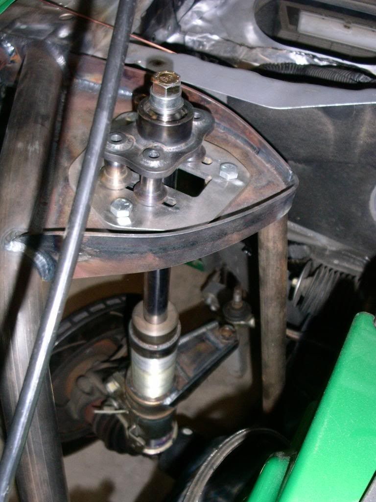

Here is a my strut setup with custom camber plates

yea somthing like that is wat im looking for ok now i kinda have an idea of wat to design
