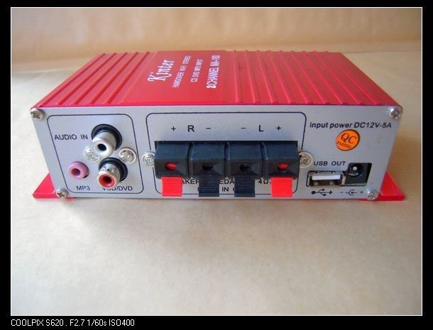

i has a question.............. i just ordered the little box...........
and am thinking about using this to connect the ipod to the box.
will this cord charge the ipod or is it not going to?
the add read this: "Hi-Fi Stereo Amplifier for Car , Motorcycle, Boat The Amplifier can be also plug in with ipod or other MP3!It has USB socket for power supply to ipod / MP3"
david lee's avatar
david lee
it appears the box you have above will charge anything, includng you ipod, with its usb out. however, you will have two plugs in your ipod, one for headphone jack, and the other for charging via the bottom plug. If you want it to have only one visible plug on it, i would get the offical ipod cable that just plugs in one spot on ipod, and the other side will have usb and three rcas, obviously u wouldnt use the yellow video. you can get it at ur local best buy or apple store for about 50$. butyour bst solution is to use some form of sound processor, like the many audio control makes.

I wouldnt mess with the Ipod usb cable I would use this
http://cgi.ebay.com/2-RCA-IPOD-INTERFACE-CHARGING-CABLE-STEREO-A11-/360221029494?pt=Other_MP3_Player_Accessories&hash=item53ded8b476
Slappy Mc Nasty's avatar
Slappy Mc Nasty
-------------------------------------------- I wouldnt mess with the Ipod usb cable I would use this
whoo hoo, i just used the "buy it now option and its a decent price............... THANK YOU!!!!!!!!!!!
