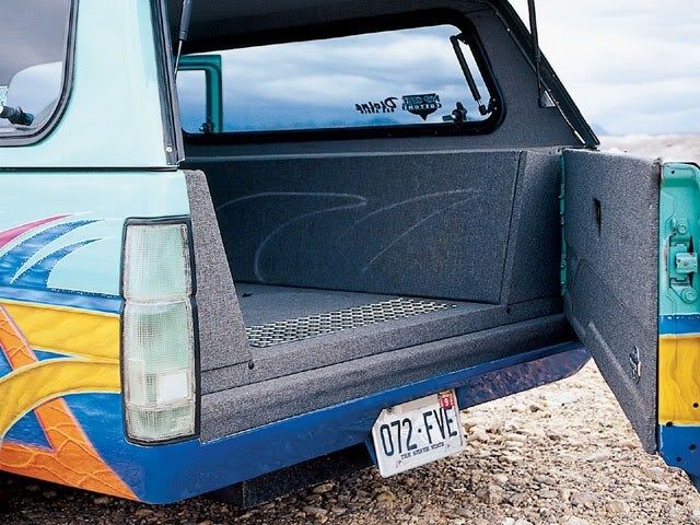

That's what I was thinking...but then I saw this.

Has no one ever done this? I just want to know all options. Even if you've done it with shaved tail lights, i'd like to see what you did.

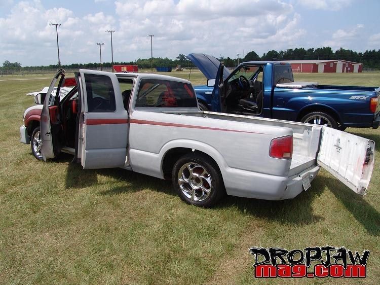

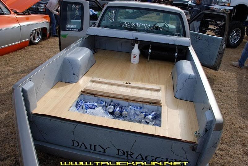

heres a few i found for ya man. the last 2 pics are my old truck but i cannot find the build up pics. must have been in my last computer and it crashed.
