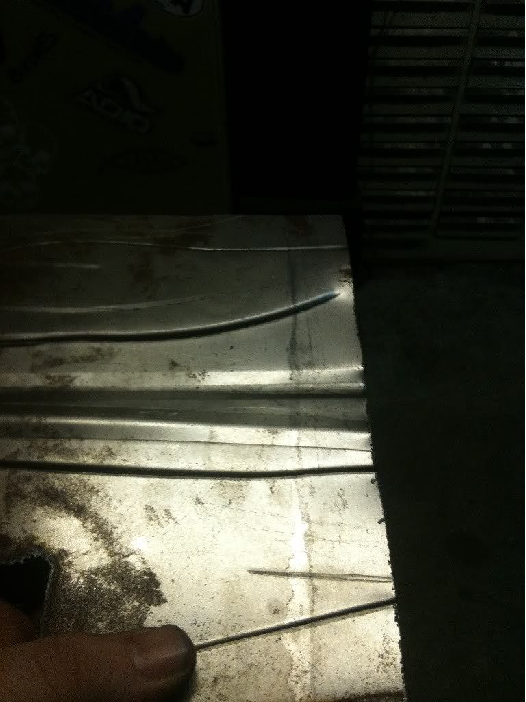

Thanks guys. It works a lot better. works better with 2 people. One to turn the wheel one to guide the metal. Hit the reason wanting to make it power. Here are few pics of the first test passes.
