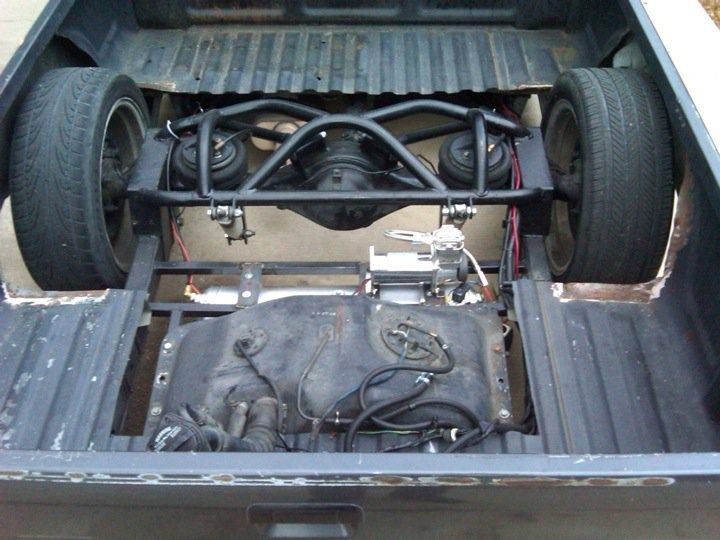

deflatd
some pics from my brothers truck

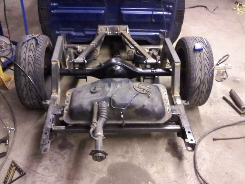

heres one we just did...cut all that shit out...box the frame and just use some one by one...easy as that...
sparage's avatar
sparage
---------------------------------------------Originally posted by onelowminiheres one we just did...cut all that shit out...box the frame and just use some one by one...easy as that...--------------------------------------------- Are the bolts just running throught the 1x1?

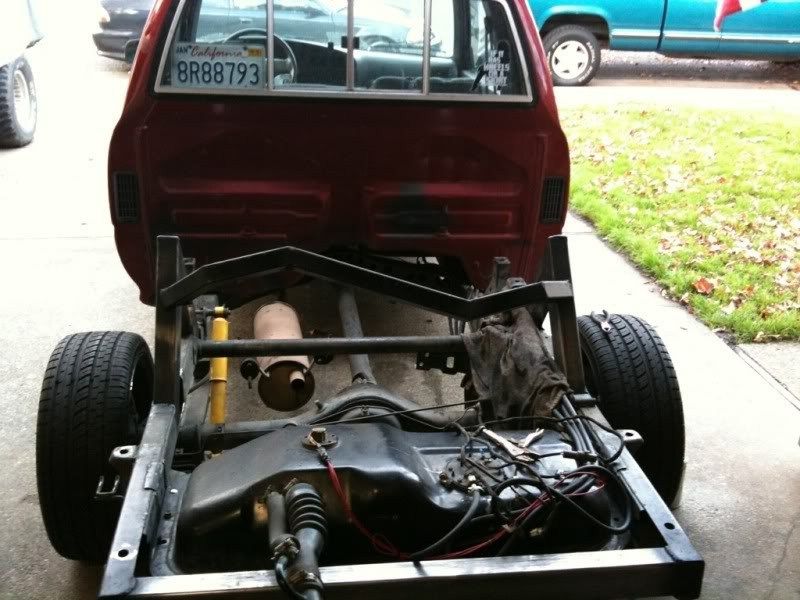

you cant really see how i made the mounts but i cut the rear crossmember and plated the ends with 1/8" plate and it is cut at the proper angle for the gas tank to set and then i just drilled a few holes and bolted it down

---------------------------------------------Originally posted by SpaRage---------------------------------------------Originally posted by onelowminiheres one we just did...cut all that shit out...box the frame and just use some one by one...easy as that...---------------------------------------------Are the bolts just running throught the 1x1?---------------------------------------------Thats pretty much how I used to have mine....mine basically the same now except I didnt put it on the factory angle....only thing it affected was my gas guage by making it read lower than it actually is

I used a toyota tank in my luv for a while and used 1x1 around the tank also with the bolts going straight through the 1x1

We just drilled through the one by one....and we got the factory angle so everything worked great...
