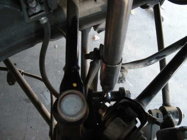

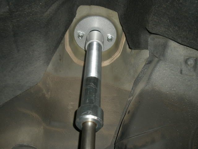

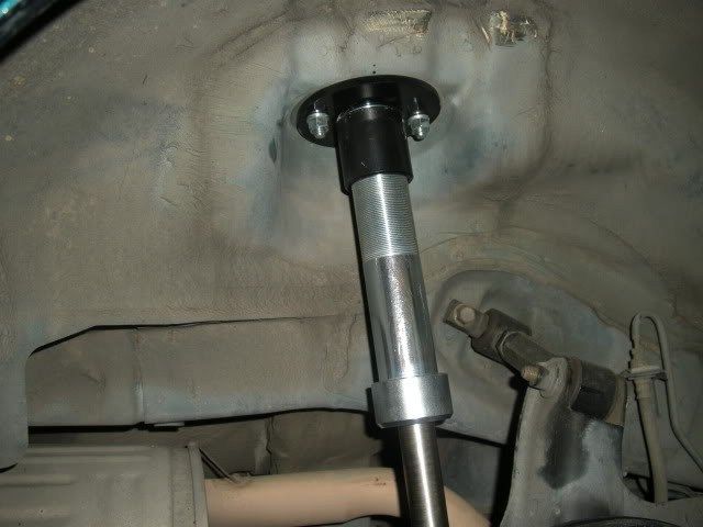

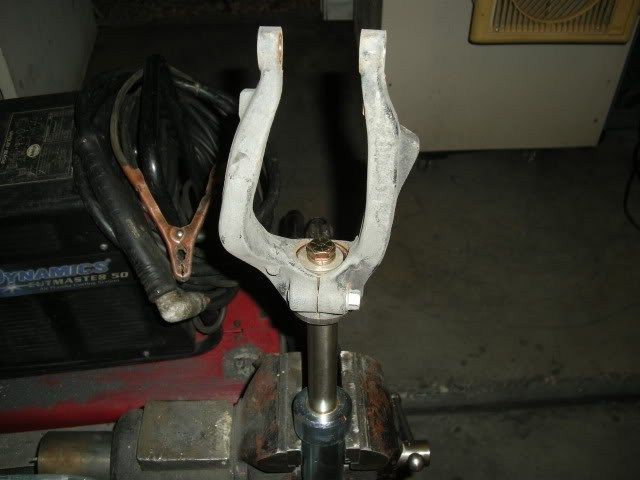

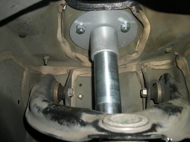

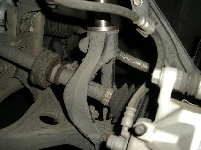

not the same exact car, but it will be just like this for the front.

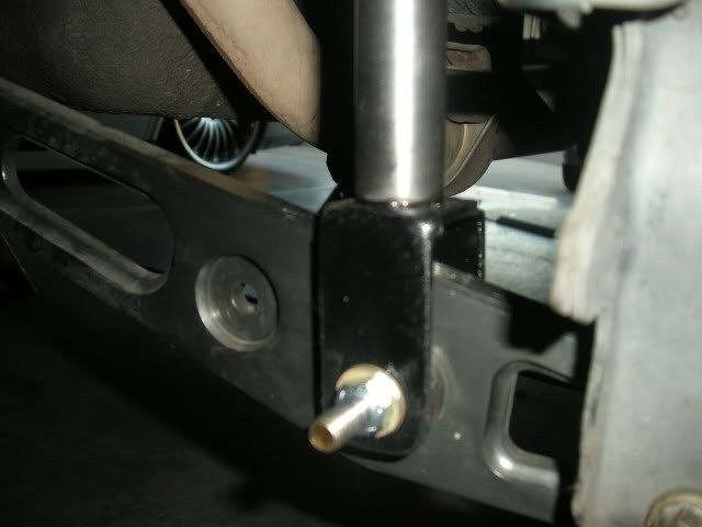

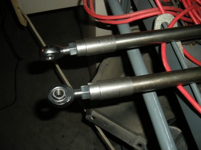

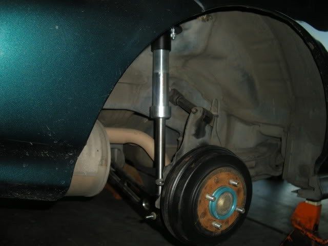

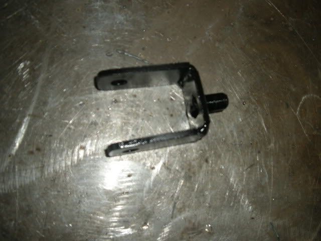

The rear will either be a heim joint or a custom made fork. If my memory serves me right, I think it will be heim. Here are a couple pics of what it will lokk like either way.
tre5's avatar
tre5
or the fork way...

one question??? if you turn the threading up on the cylinder so the cylinder sits higher would the cars sit lower??? does that make sense?
k24 rd6's avatar
k24 rd6
90-97 accord use the fork style bottom mount in the rear. Yes, if you thread the cylinder up higher the car will be lower. You are most likely going to limited by the front upper a-arms and the tires.
