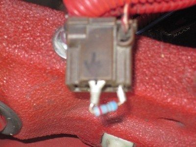

The HID light kit I got from DDM is great & went in with only a few problems!This is a H4 bulb replacement ( high/low beam) type kit, & the high beam would not come on & there was no high beam indicator.Needed a diode  in the stock light plug you leave open ( no plug into).Here is what is needed, with the male connectors soldered on.

Here is the diode in place,plugged into the low beam & ground

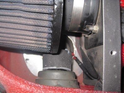

The HID bulb is longer than the stock one ,& can rub against any thing in the area. The drivers side it is inside the air box,so I made a rubber shield using a radiator hose,this was done both sides
