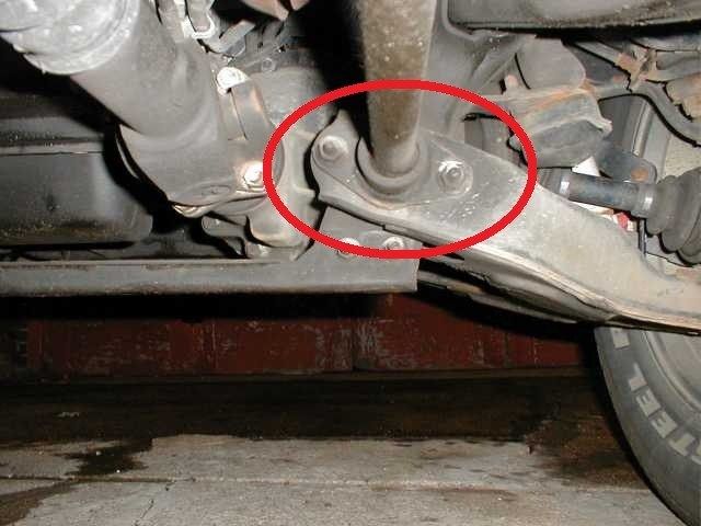

The rear bolt on the torsion bar will be bolted to the frame under the cab. The front end of the torsion bar is splined and goes into a bolted on mount on the back of your lower control arm. You can pull the bar out though may take some work. This is not a toyota but it looks the simaliar

mine looks nothing like that. Thanks tho

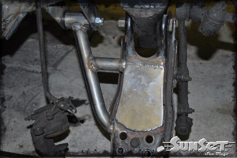

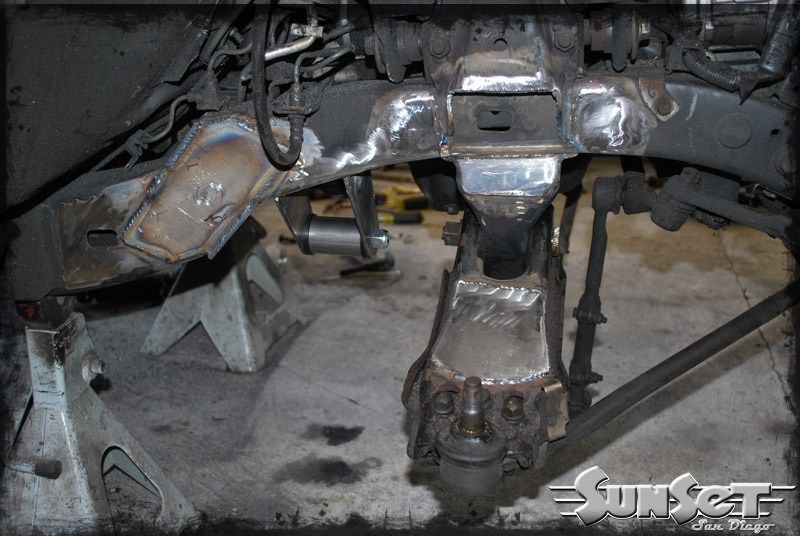

yea you take out the entire bar, you can even remove the mount from the arm, you want to keep the "strut rod" that goes to the front x member unless you are going to build a "a-arm" here is a couple of pics of mine       If you do make a 'A arm" make sure to turn the bolt around other wise you will never get it out lol

nice pictures thanks
