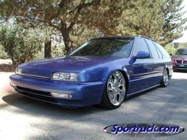

I had a 1 pump 5 dump setup back in 2002 on my accord wagon. The pump was mounted under the car, all the way at the back, where the stock muffler used to be. ( I was running a supertrapp) Fluid was a little issue, but back then I had a RC Lowrider pump and the pump head was threaded just like the Hydroholics ones are now. I simply screwed a 90 degree fitting with a short piece of rubber tubing on it so I was using every bit of oil out of the tank. Never had a problem after that.
RS's avatar
RS
STILL LIKE THE WAY THAT REAR END CAME OUT.
HarryBalls's avatar
HarryBalls
That wagon was sick!!!!! Is it still around??
