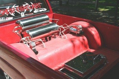

I run two 6 gal.stainless tankswith two 380Virairs,water fiters@ ea. tank & drains @ bootoms

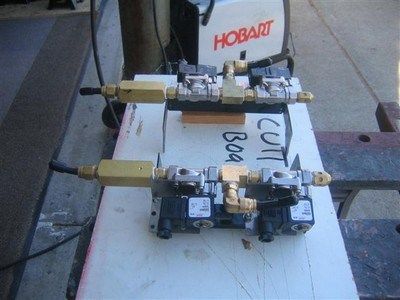

My valve manifoldsare @ the frame sides front & rear,withcheck valves
