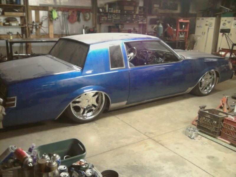

Looking for any info on doing this such as pinion angles, if I have to shorten or lengthen the trailing arms, & I wanna use the stock A-Arms too. The car is already bagged but feel the need to go lower now. It's sitting on 20's.

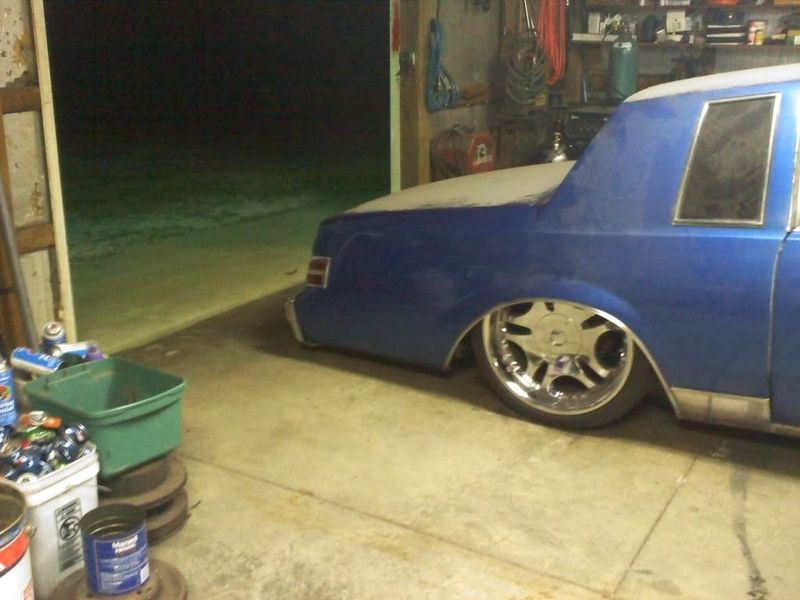

I need 5 1/2" til the frame hits the ground in the rear so I'm taking til it hits the ground.

Never bagged anything besides this Regal. Just wanted to know if I would have to lengthen or shorten the lower or upper trailing arms in the rear to keep the rear end in the same spot. Gonna do about a 6" notch & thats a big difference from where it's at right now.
