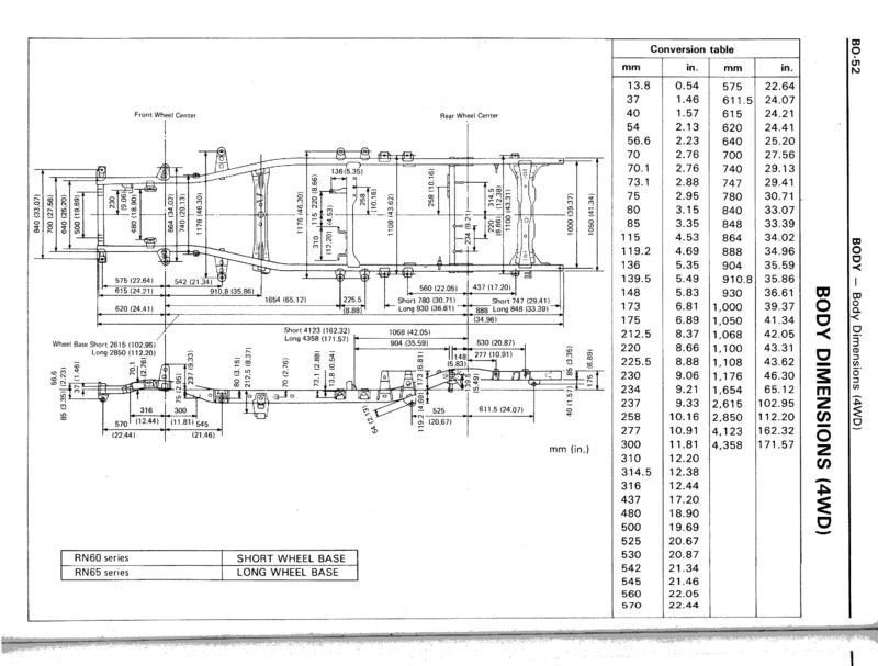

I need to know how far apart vertically the upper and lower control arms are mounted at the frame on a Pre-Tacoma.  I've looked at all the blueprints and stuff i could find but they don't show this.  Center of the upper shaft to center of the bolt on the lowers.  Thanks.

well fine then, use this instead
boooghar's avatar
boooghar
if you need it bigger, i can email it over to you, lemmie know
stlowburban's avatar
stlowburban
Boooghar I really appreciate it but I've seen that and it doesn't have control arm mounts since it's a fwd frame and those were straight axle.  There's a 2wd drive diagram in the Toyota section but it doesn't have that spec. Your a good dude to find that for me though.
