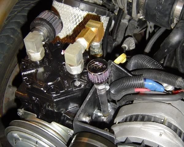

Does it have an unloader type pressure switch on it like a square D?  I made all my brackets about 3 months ago, square d pressure switch, smc check valve, grainger oil/water seperator, and it runs at least 2 times a day.   Oh, did you pull the 5/16 threaded bolt out the side of the compressor and put a vent on the crankcase?  That'll help keep the oil you have in it.  Also pour the oil out that is in it and run straight SAE 30 weight non-detergent.  12oz, or fill a beer can and pour that in.  It might leak some out the vent, but that's ok, better than burning it up. Here's a pic of the suction, outlet, and vent line.

If you don't have the vent on the side the compressor is going to suck oil around the rings and pump it downstream.  You'll run out of oil, and burn it up quick.  It's the same as the breather on an engine valve cover.  Plug it, it'll burn oil.
The square D pressure switch mounts after the check valve and the unloader line T's in before the check valve.  When the compressor pumps up and turns off the unloader dumps the air pressure off the head so when it turns back on it doesn't have to overcome 200psi immediatelly.  I got the pressure switch from grainger also. http://www.grainger.com/Grainger/pressure-switches/switches/electrical/ecatalog/N-8gnZ1z0mqhrZ1z0mleoZ1z0r564Z1z11l1fZ1z0n4e9?Ns=List+Price%7C1&op=search&sst=subset http://www.grainger.com/Grainger/items/4ZL23?Pid=search Make sure you have at least 3 feet of air hose before the coalescing filter to give it some space to cool off.
