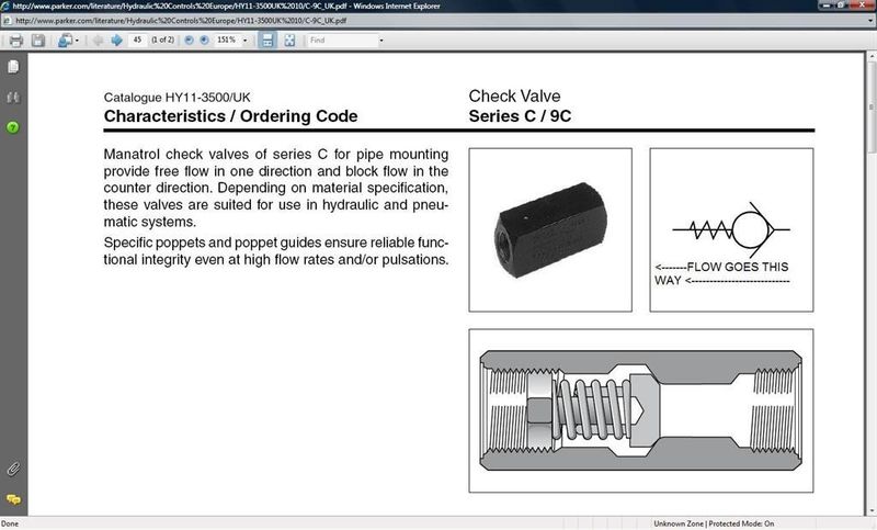

The Parker check valves can be confusing.  The flow diagram on the side is NOT an arrow, though it looks like one.  This page ought to help you determine the correct flow direction:
