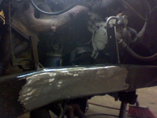

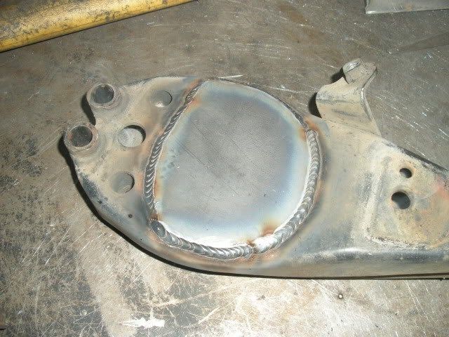

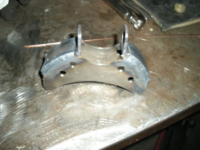

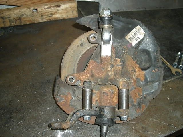

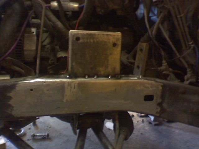

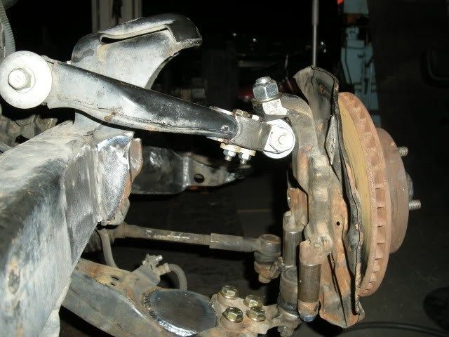

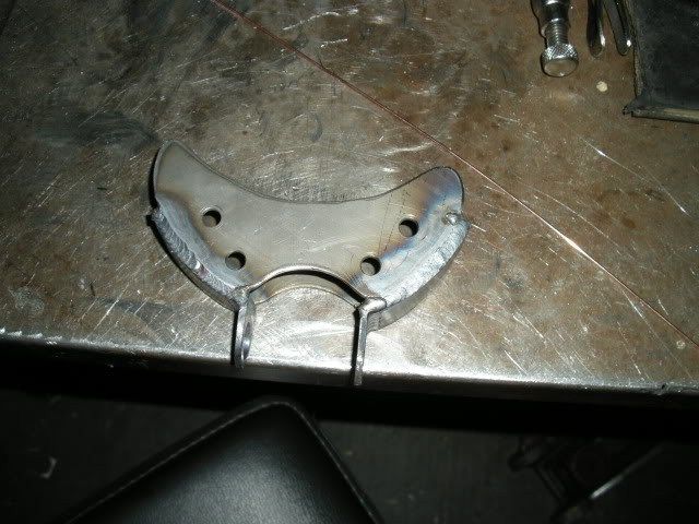

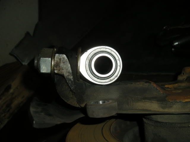

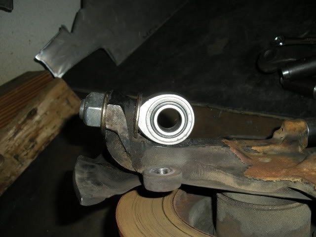

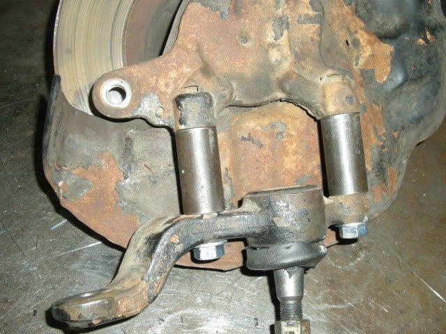

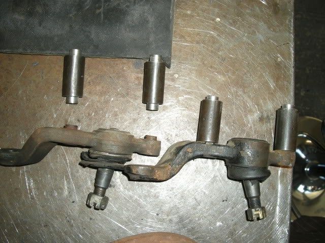

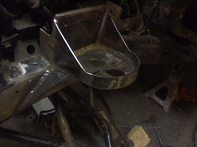

I raised my upper a arm mount up 2 inches and made a 2 inch spacer to space the spindle up were it bolts to the lower ball joint. Here are what pics I have.
jtbeasleystc's avatar
jtbeasleystc
^^ Its set up to lay full frame so if you just wanted to lay the front motor crossmember you can just run the spacers

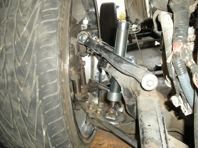

Here is one I did. It lays on 22's...
