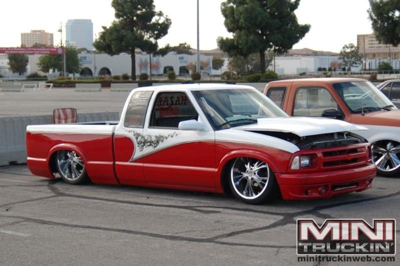

i have fleet white on my s10, pretty white to me....

---------------------------------------------Originally posted by wsitywimi have fleet white on my s10, pretty white to me....---------------------------------------------actually its not the fleet white anymore buddy, when it was getting prepped some of the white was thin and sanded through to the red. so i re-shot it all with sem color horizons bright white. all ur interior is the sem white too.  its actually whiter then the fleet white u had on it. lol
