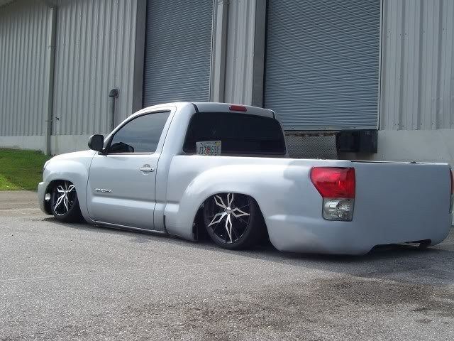

looks dope heres my tails on my 06
Generation X's avatar
Generation X
---------------------------------------------Originally posted by SPICY2looks dope heres my tails on my 06 --------------------------------------------- Yep you were the other one I was referring to bud So unless you know otherwise as well I should be the second newgen tacoma and 1st xrunner with em
